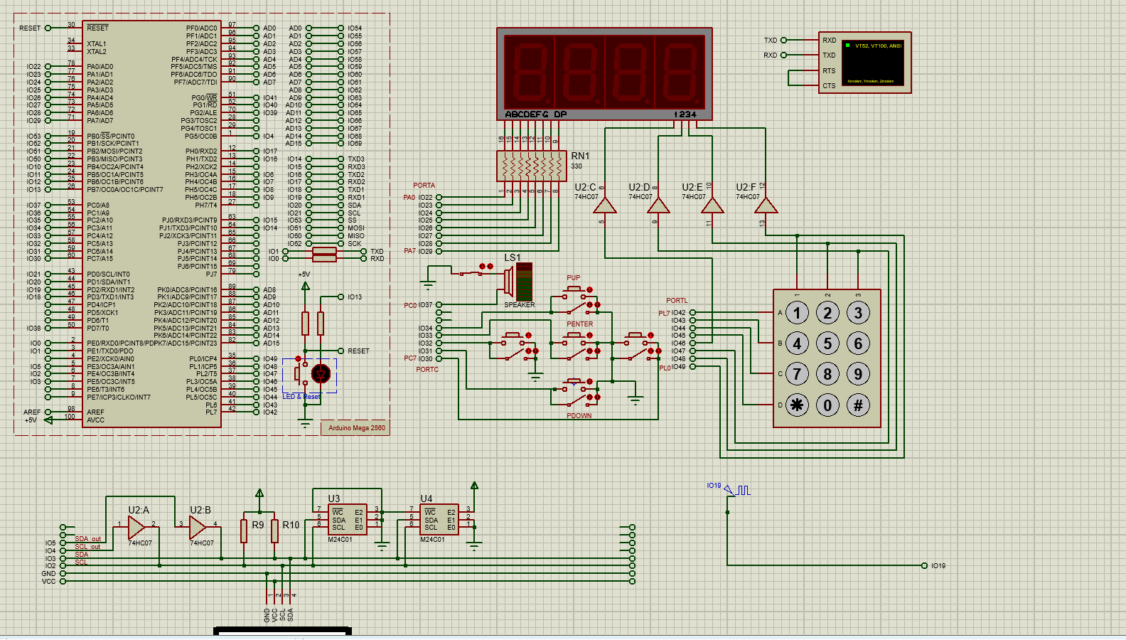

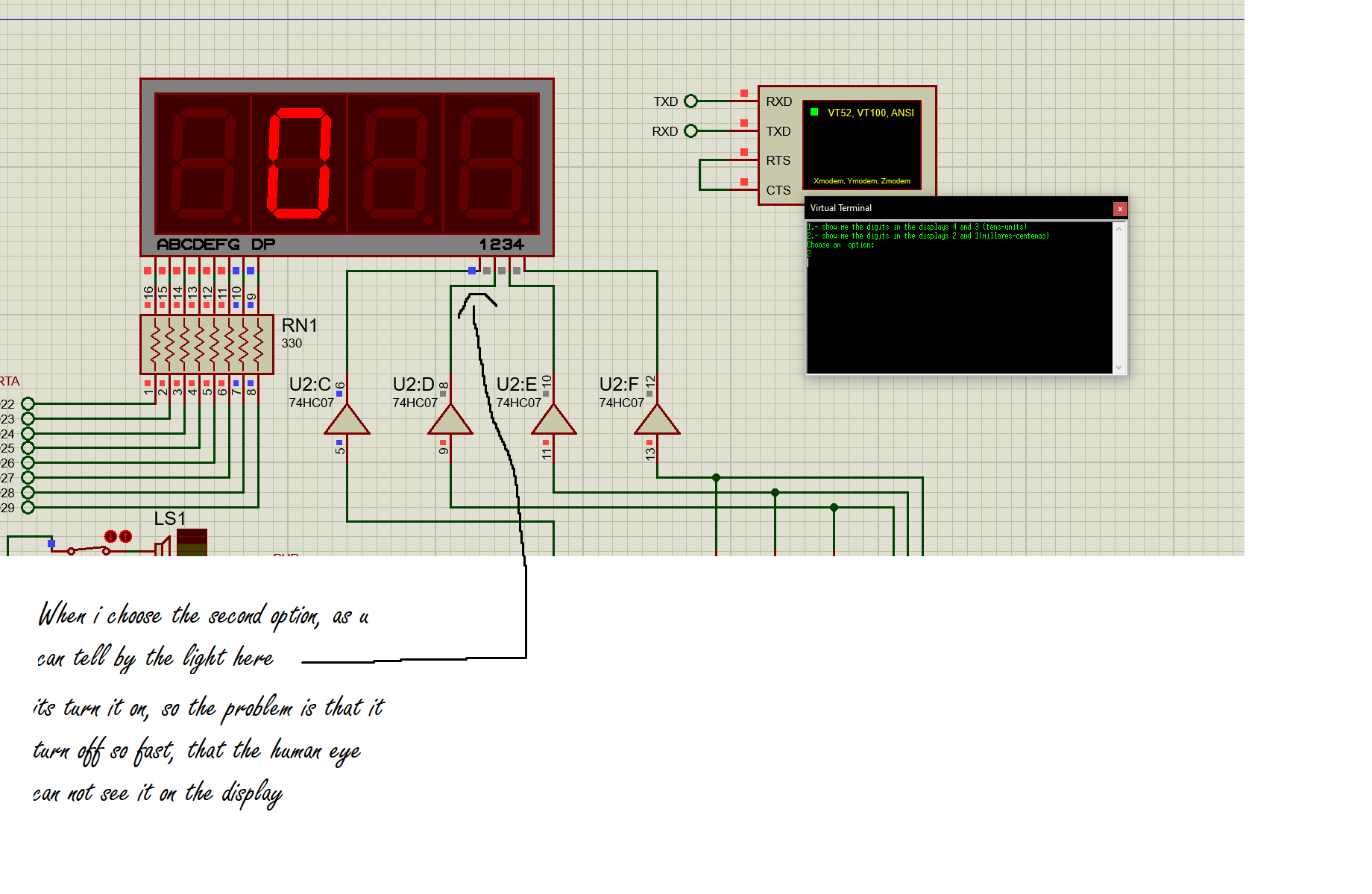

I am trying to multiplex a 7 segment display, which works through a query, That is, if I press 1, the tens and units will light up, If I press 2, the hundreds and thousands will light up, The first one does it perfectly, the tens and units are displayed. However, when I press the second, it multiplexes correctly, but the thousands digit lights up, but it goes out so fast that the human eye cannot grasp it. You will ask yourself then, how do you know that it turns on? Well, lowering the clock frequency shows that it turns off super fast, and I don't want it to do that and I don't understand why it does it. I am enclosing the project in case you want to keep an eye on it, it is not the best in the world but hey. I'm sure it has to do with electronics since, when I remove the multiplexing code from the interrupt it works perfectly, but when I put it inside the interrupt, which is what I am asked, it simply does not work and it turns off super fast .

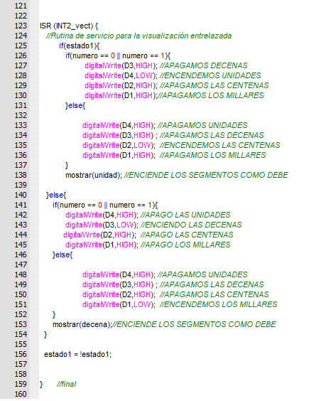

Post your code in code tags, not an image.
Don't run code in the interrupt. Make a volitile variable put it in the interrupt, set it to true. In loop an if statement tests the variable, if true run the isr code, set the variable back to false.
Post all your code.

ISR (INT2_vect) {
   //Rutina de servicio para la visualización entrelazada
         if(estado1){
	    if(numero == 0 || numero == 1){
		     digitalWrite(D3,HIGH); //APAGAMOS DECENAS
		     digitalWrite(D4,LOW); //ENCENDEMOS UNIDADES
		     digitalWrite(D2,HIGH); //APAGAMOS LAS CENTENAS
		     digitalWrite(D1,HIGH);//APAGAMOS LOS MILLARES
	    }else{
	       	    digitalWrite(D4,HIGH); //APAGAMOS UNIDADES
		    digitalWrite(D3,HIGH) ; //APAGAMOS LAS DECENAS
		    digitalWrite(D2,LOW);  //ENCENDEMOS LAS CENTENAS
		    digitalWrite(D1,HIGH);  //APAGAMOS LOS MILLARES
	    mostrar(unidad); //ENCIENDE LOS SEGMENTOS COMO DEBE
   }else{
	    digitalWrite(D4,HIGH); //APAGO LAS UNIDADES
	    digitalWrite(D3,LOW); //ENCIENDO LAS DECENAS
	   digitalWrite(D2,HIGH);  //APAGO LAS CENTENAS
	    digitalWrite(D1,HIGH); //APAGO LOS MILLARES
      }else{
		    digitalWrite(D1,LOW);  //ENCENDEMOS LOS MILLARES
      mostrar(decena);//ENCIENDE LOS SEGMENTOS COMO DEBE
  estado1 = !estado1;
}	//final

thats the code, ill change the things you told me, but i think it is an electrical problem, ill try to post the circuit
I tried, to do the thing u told me about changing the boolean in the interrupt but i have the same issue.

  //Las interrupciones??????????????????????????????????????????
   // Habilitación de la interrupción INT2, flanco de subida (rising)
   cli();
   EICRA |= (1<<ISC21) | (1<<ISC20);
   EIMSK |= (1<<INT2);
   sei();
  PORTL |=0x0F;     // equivalente a PORTL = PORTL | B00001111  (cátodos D1D2D3D4 desactivados)
										// se lee el puerto y se hace el "or" con la máscara B00001111 para poner los 4 bits
										// menos significativos a "1". Los 4 bits superiores quedan como estaban: no se modifican
										// Otra forma: pinMode(D4, OUTPUT); pinMode() para programar pin a pin (en este caso D4)
ISR (INT2_vect) {
     estado1 = !estado1;
}	//final

         if(estado1){
	    }else{
	    delay(10);
   }else{
      }else{
      delay(10);
  void mostrar(int var){

What the issue may be remains to be seen. I'm a fan of do as little code processing in the interrupt service routine as possible. Thus, while the ISR may not be a problem, developing good code habits with these MCU's helps.

I consult in the terminal, which numbers my client wants if it a 1 I´ll glow the units and the tens,
if it 2, if he presses in the keyboard the number 2, it will glow the other things,
I put the result in a variable, called "Numero" which means the number my client put on the keyboard, and it will appear on the console.
OK so the 2 is from the keyboard entry.
The issue from the description and restated is after the 2 is pressed the code changes back to its default instead of latching the 2, correct? How long should the display hold the 2 press from the keyboard?
ill show u in a picture, how its meant to be.
Heres the code with comments in English

And heres its how it should be seen.
It is an interesting problem, I think the problems end in the frequency of things about the electronic devices I have there, the problem is, i didn't make the circuit it was made by my teachers, but they don't replay me for days, so that's why I'm here, my classmates obviously don't know how to fix this weird problem, so that's why I'm here, i post it in Spanish/English trying to find out, what is going on.
mate, I change the multiplexing thing about the digits for one I saw on a forum, and now it works!!!

Why in the first place are you using an interrupt in a completely inappropriate situation? :astonished:
Is this in fact the situation we see here from time to time of a teacher trying to teach you to use interrupts when the teacher has absolutely no idea what they are used for?
