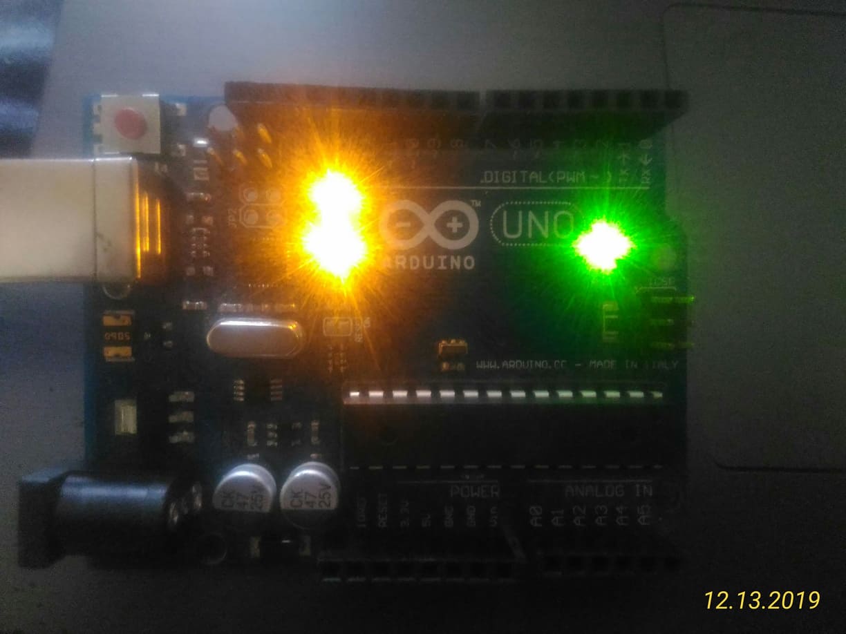

i wanted to test a sensor. so i uploaded a simple analood read exaple from the ide and as i uppload the sketch to my arduino uno. the tx light is turned on all the time. and the serial monitor shows some values. even though there is no connections the tx light keep blinking its frequency is same as the outputs of serial monitor. i thought my arduino is busted. i tried it on a arduino mega. same think happened. please help me out.

if you do analogRead on a pin that is not connected to anything, random values are not unexpected - the pin is set as input, so the arduino isn't nudging it into any defined state; it is said to be "floating" - it will pick up ambient electromagnetic noise (like an antenna*) and you'll get random values with analogRead(). Connect it to something that outputs a voltage, and you'll get reasonable values.
The same thing happens with digitalRead on a pin not connected to anything.
