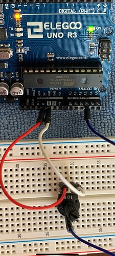

I'm a newbee with Arduino. Just started playing. I'm working through an exercise with a potentiometer connected to Uno 5V, GND & A3 in the circuit. (Attempting to insert a picture of the board with connections.)

Here's the output from my serial com port log. My returned values are all over the place (output is timestampted and potentiometer in set in the middle and not being moved.)

I was expecting the values returned to be stable and change from 0 to 1023 as I moved the potentiometer.
Can anyone provide some insights as to what may be going on?
Assume you have a wiper-type variable resistor.
Do you have one of the outer legs connected to 0V, the other outside leg of the resistor connected to 5V and the middle leg of the resistor connected to A3? All connections secure?
can you post a photo or drawing of your setup if you don't
You can also model arduino circuits on TinkerCAD and post a link there - the code can also be run from there as a simulator.
Hello Andrew, thanks for the reply. Here's the URL link to a picture. I believe it shows I'm connected as you describe.
https://drive.google.com/file/d/1lSoVWiJu9zfXtMnwUE1pgDb6W9NJ0CP5/view?usp=sharing
Reviewing the log of the analogRead(A3) values it looks like the values are cycling from low to high to low to high ...
I'm going to remove the potentiometer and see what happens... see if the voltage is varying. Without the potentiometer I would think I should have a constant 1023 value returned from the analogRead(A3).
UPDATE:
Ok, taking the potentiometer out of the circuit, just going from Arduino UNO 5v or 3.3v to A3 I get as expected... 1023 consistently from 5v, and 697/698 from 3.3v. So both my potentiometers must be faulty is my guess.

I finally figured out my problem... I had not pressed the potentiometer into the breadboard firmly enough. Reseated and all is working as expected.
