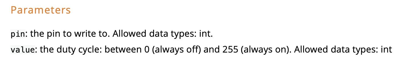

so i read on the website that analogWrite takes the "int" datatype, but no mention of other datatypes. Im trying to optimize my code to pass a PWM value to an ArduinoUNO analog-PIN.
I thought it would be more efficient to use the "byte"-datatype, but it seems to me like the output is actually lower when i use byte than when i use int? Is this placebo?
Im unsure now, since I read something about analogWrite not taking byte datatypes or halving the value?
What is the truth? :stuck_out_tongue:

I did check two processors, AVR and ESP32, and this is the function
void analogWrite(uint8_t pin, int val)
So the documentation seems incorrect, at least for certain boards.

How so? The documentation says it takes an int , the code says it takes an int.
The question is what happens when you pass an int with a value greater than 255.
I did not see any clear answer, but perhaps when assigned to registers that are byte sized something like you might want to have happen does.
