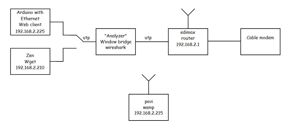

I was trying to visualize the traffic generated by the web client in Examples > Ethernet
by David A. Mellis created 18 Dec 2009, modified 9 Apr 2012 by Tom Igoe, based on work by Adrian McEwen
The analyzer is a windows machine running a bridge and wireshark capturing traffic to/from arduino, please refer to attached figure
What i do not understand is all the packets (also to port 80) which always precede the http request (highlighted in yellow) coming from arduino.
These packets appear when the request is to google or to a wamp server on my LAN
when i replace arduino by a window machine making the same request with wget, the first packet is the always http request
I’d greatly appreciate if anyone could shade some light on this mystery

I think this is about it: https://code.google.com/p/arduino/issues/detail?id=563#c7 The W5100 library perhaps does not buffer outgoing data, which result in so many TCP packets, and no one cares.
The W5100 is a TCP/IP chip. Perhaps the Ethernet library uses it as a simple TCP/IP chip without optimizations for HTTP requests.
I care. I manage the packet size by the character array size I use to send packets with client.write. All my examples in the playground use character arrays to send bigger packets.
Some examples are not very internet friendly tho. They send a bunch of packets just to send one request. :(
edit: Here are two examples. The first sends 4 packets.
client.println("GET /mypage.php HTTP/1.1");
client.println("Host: mydomain.com");
client.println("Connection: close");
//...and the worst offender! A cr/lf sent in its own packet. :(
client.println();
This sends the same request in one packet.
client.write("GET /mypage.php HTTP/1.1\r\nHost: mydomain.com\r\nConnection: close\r\n\r\n");
I understand: The request is segmented by arduino (here) because of the way the code is written. Wireshark (and of course the server) who's looking for \r\n\r\n knows when it's the last segment and shows the whole request on frame 19 though this frame has just the last \n byte. Indeed, when coded per SurferTim, the request is sent with just one 129 bytes frame.
