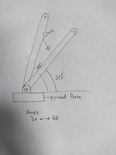

i want to make programe to measure angle by mpu6050 between 30 and 60 angle range
please need guide

Not possible with the mpu6050
I would use an optical encoder connected to the pivot shaft
so mpu do not measure angle in range ?
No idea why you would want to use that chip, given it is not only end of life, but not suited to the application you are asking about.
The optical encoder will give you repeated accuracy with a lot easier way of coding.
WHAT parameters should i see in mechanism while chosing encoder
Lots of different types although it all depends on the application you are wanting it for.
The load on any encoder and the speed at which you want to move the encoder at, are of course parameters you should specify.
Is it a direct connection or are you having it geared?
the link moving between 30 and 60 angle in software, so i have to see that angle by using arduino
The accelerometer is not accurate enough to provide 1 degree of accuracy.
The encoder should be able to operate with 5V and have a PPR (Pulses Per Revolution) specification of 360 or higher.
Use a potentiometer.

thank you for sharing so this is general code to measure angles in range?
Use the code to measure tilt and roll angles up to, but not including, +/-90 degrees.
No idea why you are trying to use this device to measure an angle.
Can you say why you want to use this device?
I can't speak for the OP, but accelerometers are very commonly used to measure tilt angles, and are essential components of 9DOF IMUs for estimating 3D orientation. They are used in every drone for flight stabilization.
comparing angles between application in software and real model testing
I realise this, but the reason is the OP asked a specific question about measuring between two angles, something that I personally would use a shaft encoder for.
There are of course draw backs in using a mems device in an application that may or may not be suitable and given this is now an eol device I was just curious as to why it was chosen.
