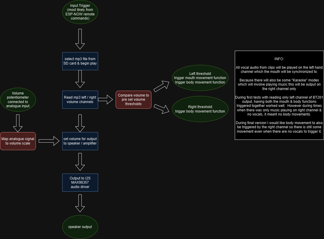

Hi all, first time poster so I hope this is in the right place & my questions make sense. I will do my best to explain my goals, current position, followed by the questions I need help with. Sorry if its a bit long winded but I figured I should get as much information into the post as possible. Also I was not sure if I should post in this "Interactive art" forum or the "robotics" forum, but as you read my design goal my choice should become clear..... basically I do not need this to be able to think/interact with environment, it more so a remote controlled prop.
Design goal:
Like many people I enjoy fancy dress when out at festivals/nights out, I am working on a few different wearable animatronics for this reason. This one is for an animatronic parrot to sit on my arm/shoulder which will sit in "idle" mode where it will do random movements/sounds at random intervals, but also respond to a remote control when needed. It will need to be completely self contained as in all electronics & power onboard, the remote will obviously be a separate module that I can operate secretly in my pocket.

Breakdown of plan/goal:
In the most basic sense I need to synchronize mouth movement to mp3 sounds played along with random body movements.
Expanding on that idea, I will run the animatronic in two basic modes;
- Idle: Store a selection of mp3's in an "idle" folder. At random intervals either play a random mp3/sync mouth or activate body motor for random time.
- Remote trigger: I have an 18650 integrated ESP8266 & 4x4 button matrix as a remote control. Split mp3's into 16 folders. Using ESP-NOW play random mp3 from selected 1-16 folder.

- Mouth/sound: This is the messy part. I have implemented code to trigger the mouth movement if the audio received on the analogue input exceeds a certain level. Watching the parrot sing to songs is most entertaining (I may be 40 but watching a parrot karaoke to "Walking on sunshine" with the voice of Gilbert Gottfreid is making me giggle like a 4 year old!!!!!) So this splitting of mp3's into left channel vocal, right channel backing track, has GOT to stay!!! With that being said there are a few issues I have run into using this BT201 sound module, which is the major cause for considering changing what I have currently.
Current issues / why I am thinking of changing
So I am thinking about moving this project over to an I2S based system instead, but I have never tackled any project using this (as stated I am a complete newbie to this!). Not to sure how I am going to explain/format questions so please bare with me;
- 1: The physical size of ESP8266, Motor shield, BT201 are at the very limit of what I can fit into the parrot. Even that is going to need some heavy modification which I am happy to do, but would rather avoid. Either way there will be some heavy modification to add extra space for the battery pack. The location of the original controller board really does not offer much in the way of usable space as both the circuit board & the parrots body was built around this, there for I am planning to use the area of the battery pack to hold the electronics & then add a hidden battery compartment elsewhere.
- 2: The ESP8266 motor shield only allows access to 8 digital I/O's & 1 analogue input. 4 of the digital I/O's are linked to the motors. So if I continue to use this setup I am limited on what I can do.
- 3: Only able to read analogue on one channel. As stated, the music/signing is very entertaining so will be something I plan to keep, however both the mouth movement & random body movement are triggered by the vocal input, this means there are times where just the backing track are playing & the parrot sits dead still. It would be nice to be able to read both Vocal/Music channels so I can sync mouth to vocals but also still have random body movement if music is playing. I think that I could query the BT201 to see if playing = true & use that to trigger the random movements, but I am concerned about sending to much traffic across serial to/from the BT201. Not to mention that I also need to make the serial connection in the first place which will cost 2 of my I/O ports and also having to try & make sense of the AT commands around the internet.

Audio section / where my real questions are: The BT201 board is pretty large, the footprint is the same as the motor shield, although 1/3 the thickness. Connecting to this board through serial seems a little be janky & limited, this is why I am thinking about swapping over to I2S instead but have no knowledge at all about it. So today I have been having a little read/look at the following library & modules. The following questions are where I would like some confirmation or guidance before I spend out any more cash on things which will end up living in my spares box!!
So this is the library Arduino Audio Tools
I2S Amplifier Max98357
SD card reader SD card reader -
Q1: Would that SD card reader be suitable? Either way having a small reader module would help with space limitations but also mean I could place it in a more suitable area for access when I need to update the files.
Q2: I believe that selecting a folder & playing a random mp3 would be easier to code using this SD reader than trying to code AT serial commands for the BT201 module, or am I thinking wrong about that?
Q3: Am I right in thinking that using the "VolumeOutput class" of the library I should be able to measure the output of both left/right channels, allowing me to synchronise mouth movement to the left channel & random body movement to the right channel?
Q3A: This is more a thought as I do not really need it but might be nice to look into later on down the line when everything else is complete..... Using this setup would it be possible to count beats on the right channel? kind of like you see with disco lights etc? this would allow me to sync the random body movements to the timing.
