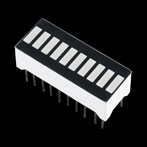

Ah, the LEDs trick! Yes, I had forgotten about that. I can see how it can be a valuable strategy although I imagine that it can be somewhat tedious to need to set it up, both in code and requiring an LED somewhere. I do have an oscilloscope but I'm just getting into that domain. I got myself a cheap one which as I understand it isn't completely helpless. I'll try the digital pin flipping and reading it with the scope. Do scopes generally have the ability to count the number of triggers in a given time period?
bombarie:
I mounted one of these:
... on a protoboard with resistors, a header pin per anode, one header pin for all the cathodes common'd. Now I have a bank of 10 leds at hand always.
The one I used has some red, orange, green and blue leds.
Ooh, I can see how that's efficient. Thanks for the idea, I'll see if I can use this on a next project.
Nice idea! ++Karma.
I wonder if anyone makes those led banks with resistors for 5V built in, like some discrete leds?
Actually they're so bloody bright, a resistor to suit 12V would still give a good indicator at 5V.
