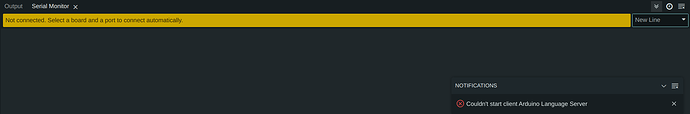

Arch Linux: Couldn't start client Arduino Language Server
Please provide details.

In Arch Linux you can install arduino-language-server from AUR e.g. by
yay arduino-language-server

:: Installation fortsetzen? [J/n] J
UUCP group solved it
Command: sudo usermod -aG uucp <user>
There you go
I got this install and restarted the arduino IDE then the error got resolved!
