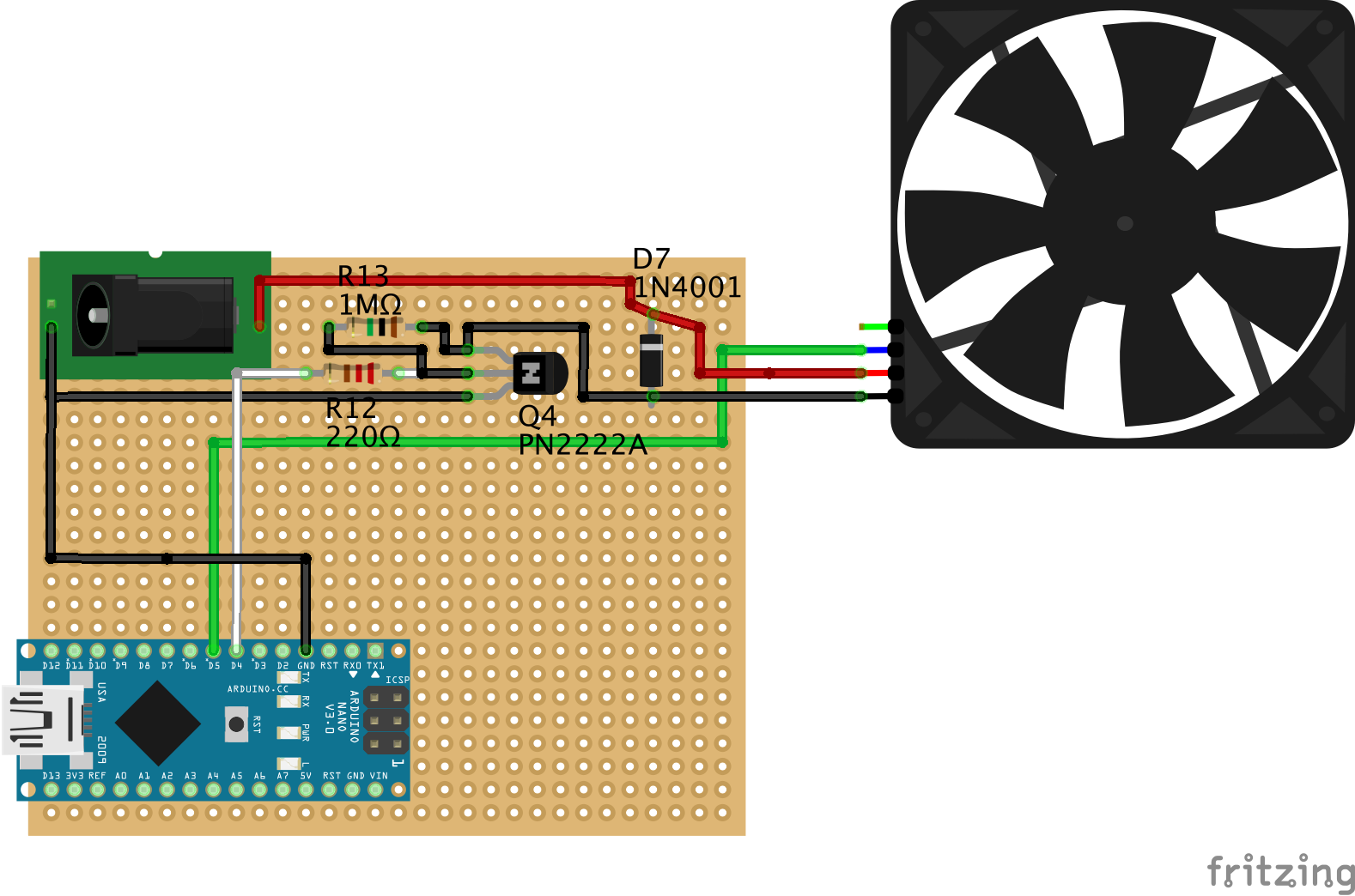

I put a circuit in the attachments. In the official datasheet I did not find any information about the frequency...
Thanks for the circuit.

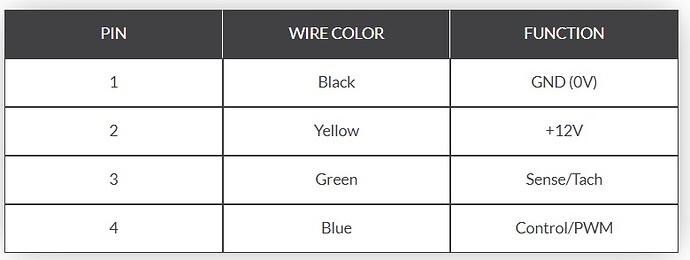

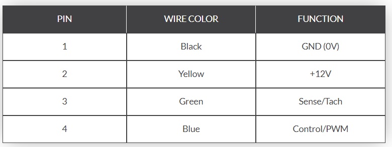

Some Noctua document, page7.

In another thread of this forum I read I should GND the emitter. So I did as seen in the attached circuit.
When I don't plugin the PWM wire (green, from D5), the transistor properly toggles the fan on / off. But when I plug it in, the transistor is constantly "switched on". I don't see what I'm doing wrong here... do you have an idea?
Cause: The transistor switches the GND line, so the PWM is the alternative GND line.
Solution: This circuit works properly for me: High-side switch 24V 6mA control by Arduino - Electrical Engineering Stack Exchange with Arduino_PWM_Pin to Fan_PWM_Pin.
