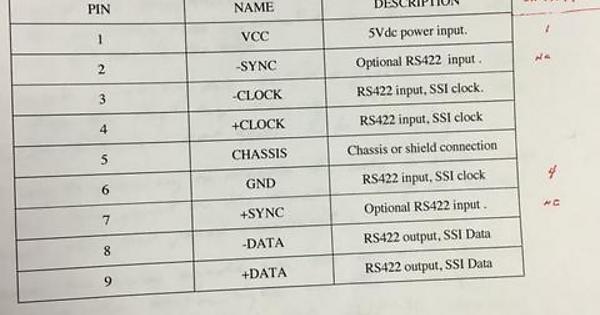

I can't seem to find another copy of the manual online, other than the one that was emailed to me.
clock is over RS422
DATA is over RS422
I am using the TI chip to make CLOCK+ CLOCK- to just CLOCK and DATA+ DATA- to just DATA
Here are some of the documents
I am using a TI SN75178BP to convert CLOCK+ CLOCK- to D and DATA+ DATA- to R.
Is that a bidirectional interface chip? How do you have it connected?
I've seen reference to SN65HVD179 http://www.ti.com/lit/ds/symlink/sn65hvd179.pdf

Ok I have it getting data back now... someone unplugged my Negative lead, I didn't see it till today.
I used the code in the other page linked, and then modified it.
