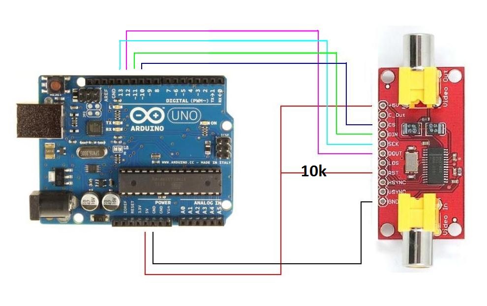

Hi Ingenn
Was wondering what hardware/schematic do you use to have this osd code working(i just changed the pin numbers to match uno 10,11,13,12). I tryed with minim osd board and it's not overlaying anything, tried with arduino uno and max7456 bob and still not displaying anything. Atached is wiring diagram i used.
Thanks buddy

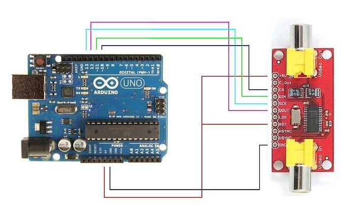

To Supercln.
You need to use a 10K resistor from 5v to RST.
Forgot to say,you also need to use a 120ohm resistor between GND and CS = ChipSelect on MAX7456,with this libraries,i dont know why.
Hi Ingenn
Thanks for your reply. I haven't had time to play with it for a while, but here i am again.
I have tried as you said 10K and 120ohms resistors and still nothing displays when there's a video in.
When i turn off the video source i get the overlay on a grey screen.(see atached pic) this is with the lib and code/wiring from this page.
Any ideeas?
I'm using PAL, do't know if this is the issue.
Thanks
