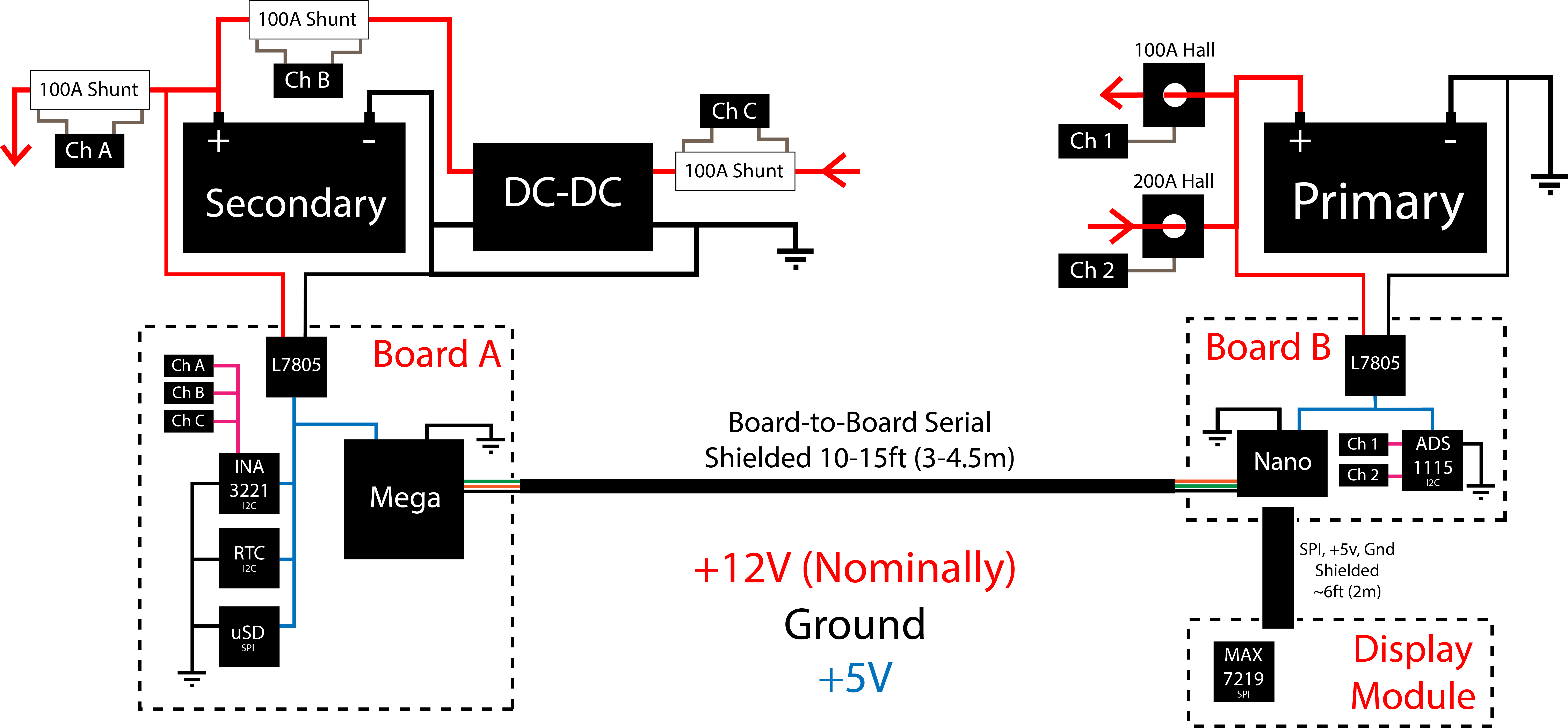

Can you draw a picture ? Write the lengths of the cables, draw the ground and power lines as well.
Yeah, give me a bit to mock something up!
Here is the rough layout of things. After thinking about it a bit, I moved around where the shunts and hall effect sensors would go. Also moved the MAX7219 over to the Nano (board B) since I can run a shorter cable for the SPI connection to the display module than if I ran it off of the Mega (board A).
On the shunt channels, channel C would be the longest at about 3ft (1m). The other two would be within 1ft (30cm).
On the hall effect sensors, the wires should be 1.5ft (50cm) or shorter. They will be getting +5v and ground from board B.
It is hard to tell if there will be high ground currents through the wrong ground wires or if there is a ground loop.

Yes, the original plan was to have the ADS1115 on the hall effect sensors to digitize the readings and send them back to the Nano over a distance. Now that there isn't a need for that, I could just use the analog pins to measure the voltage instead. I'm already building a voltage divider to measure the primary battery voltage so removing the ADS1115 would simplify things.
