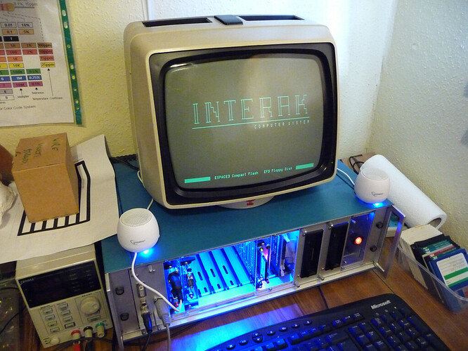

I still run and build/modify an old Z80 based CP/M Computer from the 80's and still have fun with it.
I good idea would be to be able to get a readout of the current Memory Address and the 8 bits of Data.
