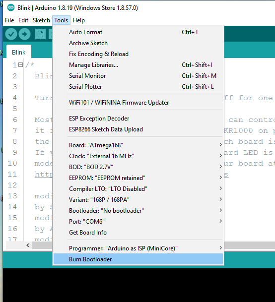

Step 2 - Upload huge sketch
using ARDUINO as ISP Using Core:Minicore (no bootloader option)
menu option Sketch --> upload using programmer

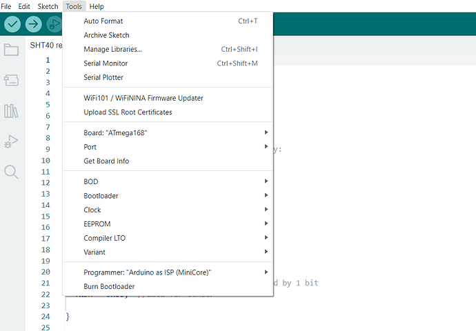

Also, what are all of the options set in your "tools" menu?
Sure:
BOD: 1.8V
Bootloader: Yes
Clock: 8MHz
EEPROM: retained
Compiler LTO: disabled
Variant: 168p

However, I think I've figured out what is going on...
If your intent is to upload over ICSP, you should set the "bootloader" option to "none."
Or use the "Upload using Programmer" option from the Sketch menu. (Hmm. Shift-click-upload doesn't seem to work any more in 2.x)
The IDE thinks you are uploading using the bootloader, and thus includes an avrdude command (-D) that specifically disables the chip erase.
Normally, if the IDE think sit is uploading via the bootloader, but the device is connected via ICSP, the upload would simply fail, because Arduino as ISP and the bootloader use different baud rates. But because of your unusual setup (using a Xiao, with its native USB connection) as the programmer, it happens to ALMOST work, except for the lack of the erase.) (The bootloader doesn't implement a chip-erase command; instead, it erases each individual page as it's received. ICSP programming doesn't have a Page Erase function (at the chip level), so its only choice is the full chip erase before it starts.)
Good detective work.

Hello guys, I finally come around to this issue and unfortunately it did not work.
I set the programmer to "Arduino as ISP" and used "Upload using programmer", but it simply said it can not get response from "STK500".
So really I seem to be stuck?
It was with programmer "Arduino as ISP" and the ArduinoISP sketch loaded your XIAO ?
Is this the same combination that you used to, apparently successfully, set the fuses on the ATmega168P ?
Correct. I really hoped this was the solution.
I'm running out of things to suggest but you could try this test with the IDE:
  1. Attach the programmer (XIAO with ArduinoISP)
  2. Select board 168P in the IDE
  3. Select the "no Bootloader" option
  4. Select "Arduino as ISP (minicore)" as the programmer
  5. Run Option "Burn Bootloader"
The last option won't actually burn a bootloader, but should set the fuses . If that fails, post the entire console output.
Incidentally, I had to upgrade to minicore 2.1.3 to see the list of programmers.
Your configuration should look like this (I can't test this though) :
