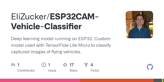

This may be of interest?
Interesting project, but it looks like it took a heroic effort to get the vehicle classifier to even run on the ESP32.
It does not appear to be practical for general applications.
