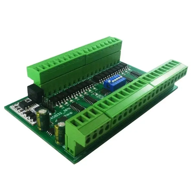

Good afternoon, I should check the presence or not of voltage in a 12/24v system (approximately 20 switches), I don't have to control them but only check their status, it is possible to use in reverse mode (read) a cheap china IO Isolated module whit RS485
to have as few cables as possible I would like to take advantage of the serial connection to manage these switches that I would like to show on a monitor, I would like to ask you if this is feasible for you or are there other ways to do this..
thanks a lot
As I understand the description, that device is input collector, so exactly what you are looking for.
thaks a lot for the reply, in fact it is input, I don't know if the Chinese manufacturers mean input and that's it or if it can actually be used as an I/O too, I tried to use uctocupler as a voltage analyzer with Arduino Uno, but here things are very different, there is the serial protocol involved and in fact I already have to use a PNP board
I'm not able to understand from description, but from the image I could expect it having outputs as well. Looks like there is four 8ch transistor array chips.

sorry, the use of this is to make a new dashboard in a late 90's iveco army truck, the engine control (rpm/allarms ecc.) arrive from canbus the rest from analogic switchs,
I would like to manage the canbus with a serial, group the analog ones and make another serial,
