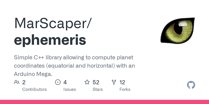

this is not solar tracking. this is bright light tracking. if you have a cloudy day, and the clouds dissipate, will the tracker be pointed at the sun? this serves no purpose and solves no problem.
the position of the sun is a function of location and time. it does not require tracking, it requires pointing, that which is called solar tracking is a form of clock. you point the object that needs to see the sun at where the sun is predicted to be, and if the weather permits, you are looking directly at the sun.
if you want to "track" the sun, find a sun tracking or ephemeris library, and find an example program that uses that ephemeris library.
Never understood why "solar tracker" builders don't make a one axis tracker with the rotation axis pointed at the celestial pole and rotated 1 degree every 4 minutes. The celestial pole is due North or South (depending on hemisphere) and degrees of local latitude above a level (horizontal) line. The declination (vertical axis) could be adjusted manually every week or two as the seasons change. Or that could be automated fairly simply as it only needs to swing about 47 degrees over a years time.
