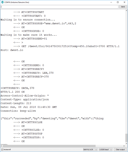

  • At a certain point we hit the point in the sketch where the postData() function is used. It runs something like "AT+CHTTPSSEND=" as in the attached picture, then Arduino sends the URL[] and/or body[] arrays when it sees the ">" character response from the modem.
  • Please note that this also crashes with a GET request which doesn't even involve the body[] array at all, although it's initialized. For example, declaring URL[300] can cause the sketch to crash if the modem is configured to run lines 346-347
