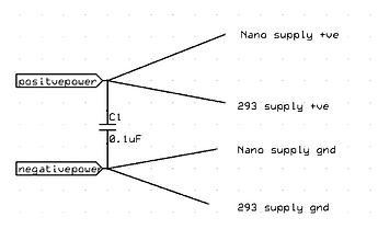

It sounds like the Nano and the motor driver chips are sharing the same power wires, so motor current noise is being injected into the Nano and other circuits.
You could try connecting the motor power and Nano power to the power source/input at the same point, like a star connection of positive and a star connection of negative.
Also 0.1uF caps across the motor terminals and across the power input pins to gnd at the 293.
Also one in parallel with C1 as close to C1 as possible.
Hi Tom,
Thank you very much for your reply. I added a ceramic capacitor in between the L293D and the motor, another one betwen the L293D and the star, another between the star and the Nano, and two more close to C1. The noise seems to have lowered (now it don't get random interrupts for no reason, like it used to).
However, connecting D2 to the arduino GND still doesn't trigger the interrupt, but as I said earlier, connecting it to the battery's GND seems to work (and also I need to improve the wiring).

I hope you mean between the motor terminals on the motor.
Between the Vcc pin and gnd at the 293.
Good to hear and improvement.
Sounds like you need to check your gnd wiring.
