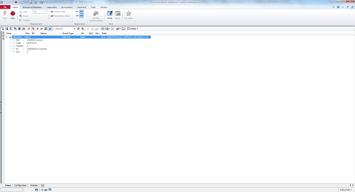

I have connected CAN_H, CAN_L and GROUND of Due CAN shield with Vector CAN Analyzer 2Y cables with the following settings-
Pin 2 for CAN_L,
pin 7 for CAN_H and
Pin 3 for GROUND
but I am not getting what I am sending. Also, from vector CANanalyzer software, I can see that Channel not becomes active all the time. If I connect and disconnect the Pin 2 then channel becomes active but the CANanalyzer software receive Error data. I have also attached the screenshot here. you can see ID from screenshot which is not that is sent from Code. In addition there is no data.
Can anyone Please help me with the problem... I have also read the other posting but could not figured out where I am mistaking... :slightly_frowning_face:
