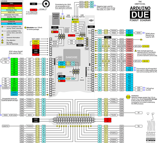

You have to do this in hardware, as you will struggle to get an D/A that handles negative voltages. This is very easy to do. Just two resistors and a capacitor. For a Due the top resistor would be to the 3V3 pin not the 5V one.
Audio Bias
No.
PWM can only produce values from 0 to Vcc. Where Vcc is the voltage of the processor driving the pin. However, you simply use the above circuit with a PWM generated output signal.
So either the D/A or PWM can be used to provide the output you need.
Note like a lot of pins on the Due, DAC outputs can handle very little in terms of output current and is very easily damaged. This is 3mA source and 6mA sink current.
This pinout shows you which is which:-
