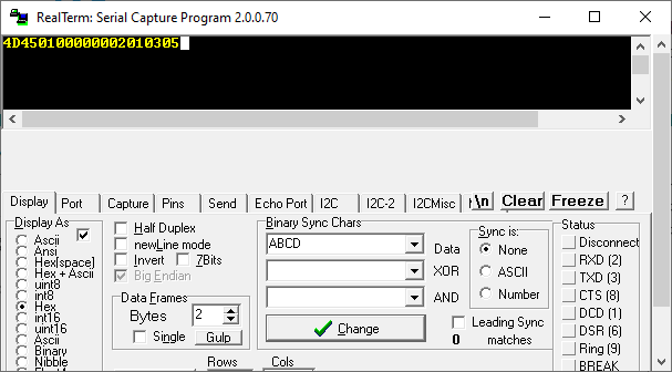

running your program of post # 1 on An Arduino Due connected to a RS232 shield connected to the RS232 COM1 port of a PC
ReadTerm displays (which is correct)
if I connect the RS232 shield VCC to the Arduino Due 3.3V - a scope displays the Due Tx signal
you can see the RS232 voltage range is -6 to 5.5V which is too low for many RS232 devices
if I connect to RS232 shield VCC to 5.0Volts the scope displays the Due Tx signal
voltage range is now -8 to +8 which is still a bit low
