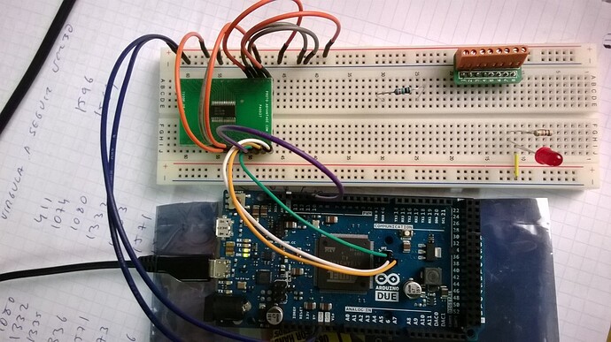

Hi, I bought a TI ADS 1248 to build a precision probe.
I am trying to read the internal probe builded in inside the ADC, but I cannot read nothing....
How can I read this temperature probe?

Thank you for the reply.
I wired the adc to arduino by spi, and use this code, and do not return values, only FFFFFF.

Where is the rest of the code ? There are no SPI pins declared in this sketch.
This is the code I have, spi pins, I use teh CS = 10.
SPI pins on UNO are 10,11,12, & 13.
Post a schematic (or photo of one) of how you connected it.
I am using Due. I thing the spi connections are ok, the code....
