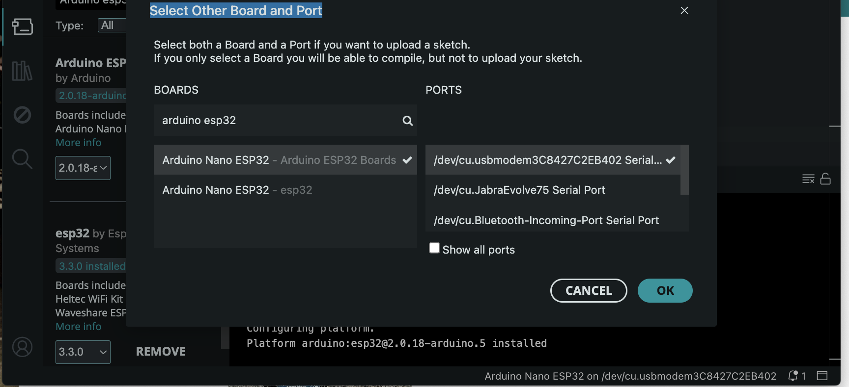

I have a Mac M2 pro connected to A-IDE and a Orginal Arduino Nano ESP32. I can upload no problems, but when I want to see what's printed in the Serial Monitor I get this message: "NOT CONNECTED. SELECT A BOARD AND A PORT TO CONNECT AUTOAMTICALLY"
What am I missing?
The basic program "Blink" will upload and execute, but any "Serial Monitor" programs will prompt this error.
Bonus info: Same message on a Window laptop, hence not related to Mac only?
Try clicking the icon on the right, but first are the baud rates matched? The rate you see in the monitor and what is coded in your sketch?

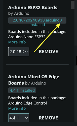

Let's verify the board you are using. Show me the same thing as this
And this is your board correct?

Usually each window of the IDE will be connected to a given port, and associated with a specific board. These are assigned separately. Both Board and Port are listed under the Tools menu. There's also the selector control on the toolbar, to the right of the three buttons to Verify/Compile, Upload, and Debug. "Select other board and port" is accessed from the bottom there.
Your screenshot shows that the "/dev/cu.something" port is selected ("cu" stands for "calling unit"). And the very bottom right of the IDE shows the board "on" the same port, and does NOT say "[not connected]" after.
If you can Upload then obviously the connection is working. If it's just the Serial Monitor, have you tried clicking the icon in the toolbar, all the way on the right, to first close it; and then click again to reopen? Does that still have the yellow "Not connected" banner? Try unplugging the device to see "[not connected]" at the bottom right, and then plug it back in? Those two parts of the IDE should agree whether a device is connected or not.
(If the baud rate is wrong, it's likely you won't see anything, or you might see garbage. But that doesn't matter if the Serial Monitor does not think it is connected. The fact that you're seeing this on two separate computers, each with a different OS, points towards the common factor: that specific board)

Try this sketch, I have it working with Arduino NANO ESP32 on the 240930 board same as you. Do NOT click on any update message as that will reload the broken boards.

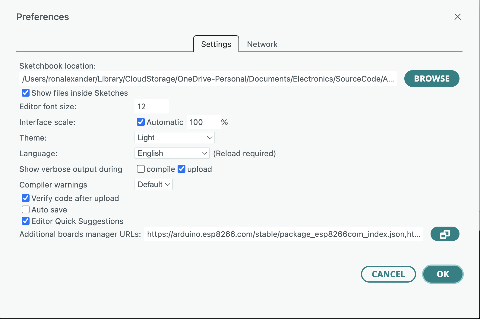

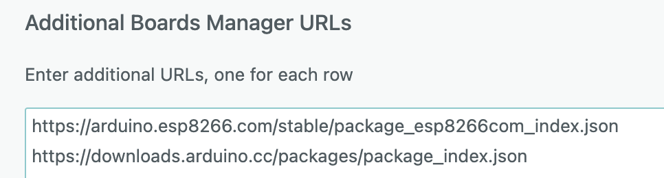

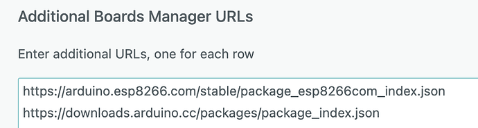

Here are my settings and additional boards. NOTE AVR and ESP32 are built in now, that is why you don't see them.
A couple of settings you might want to change are 'verbose .. during compile' and Auto Save. Some folks like Auto Save some don't. I have verbose compiler off because the compile runs much faster and I don't make many errors that require verbose.
