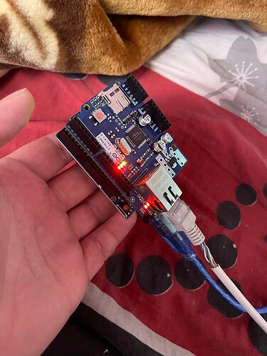

i am new to this things this is my first project that i have ever done so dont be harsh on me if i have any mistakes
i got an Arduino uno and a Arduino Ethernet Shield Rev3 and i tried to do connect the ethernet shield with the router using a lan cable and on Arduino IDE went to File-> examples -> Ethernet -> DHCPAddressPrinter which i think is tells me my ip address for my Arduino but the output is "Failed to configure Ethernet using DHCP" did some research didnt find anything to work

The purpose of the project is to send data to a database
thanks for helping

I didnt know how to tide up the code its the sample code that it is available in the Arduino IDE the output is failed
I have connected my ethernet rev3 to my router and yes it has DHCP Server with this code it shows me the ip address of the arduino but the output it says failed to configure ethernet using DHCP
i the arduino to send data to a database through ethernet

the photo appears to show a stack of 3 boards- Arduino, Ethernet shield and ??
I have had problems when using multiple boards of devices using the same pins for CS etc
Its not 3 boards
Its arduino and the shield

it is home network and yes i can connect my laptop through ethernet no problem
i have searched everywhere still no cure what i have done wrong
what do the various LEDs on the board do?
try wireshark to monitor the traffic on the Ethernet ?
