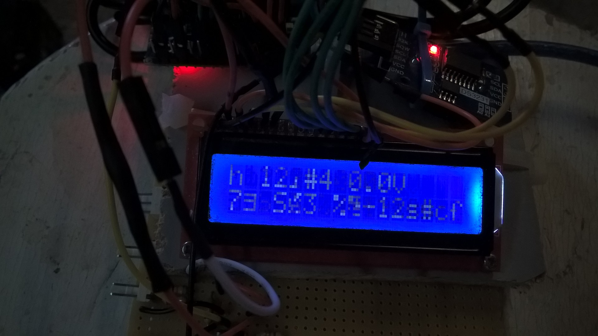

I'm building a bike Dashboard with a LCD displaying several parameters. Today I ran a test but it seems the arduino is getting mad near the engine. As I place it at ~40cm next to the ignition, my RPM is caught as it should. But when it's closer, even the speed returns a value (the input is not wired yet). Everything in my display starts scrolling, blinking, showing weird characters (see the image).
It is a prototype so wires are large and running around the board (maybe a part of the problem ?).

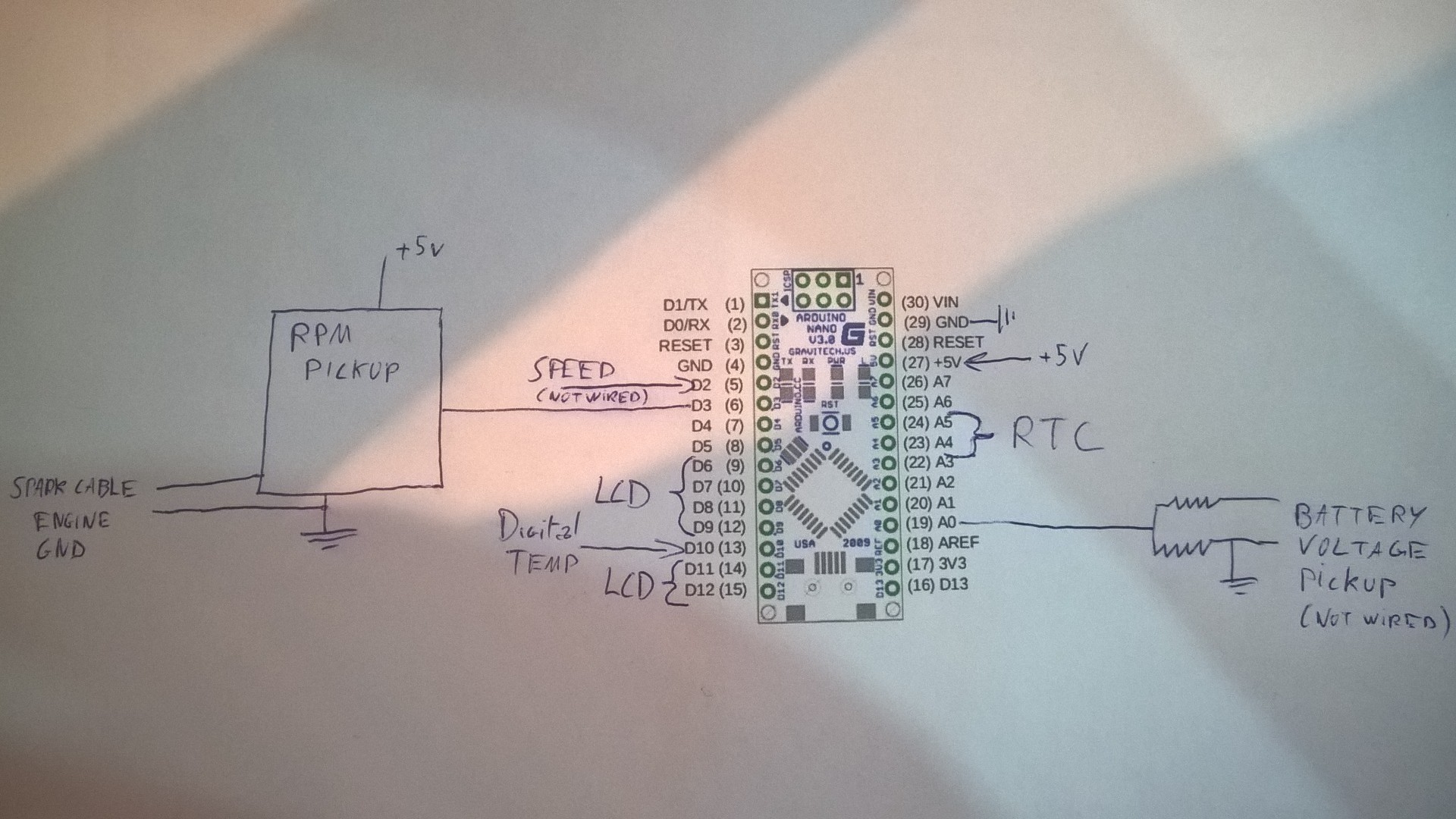

Can you please post a copy of your circuit, in CAD or a picture of a hand drawn circuit in jpg, png or pdf?
Thanks .. Tom.... :slight_smile:
The board is connected to a mobile power bank not the bike battery.
Should I add filtering capacitor to the rpm pickup circuit ?

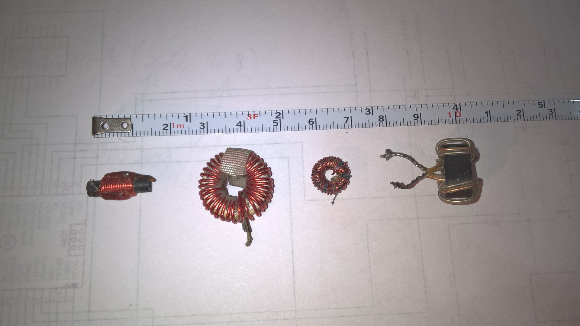

What about the size of those ferrite cores ?
I've got scrap coils (attached image). Can I use something either by decoiling it or serial add in my pickup/supply/gnd lines ? (I don't know the specs)
I would try the largest of the 3 right hand coils in the image.
EDIT: The second and last (left to right) look good. You could serial add them. Trial and error ... see which coils work best.
