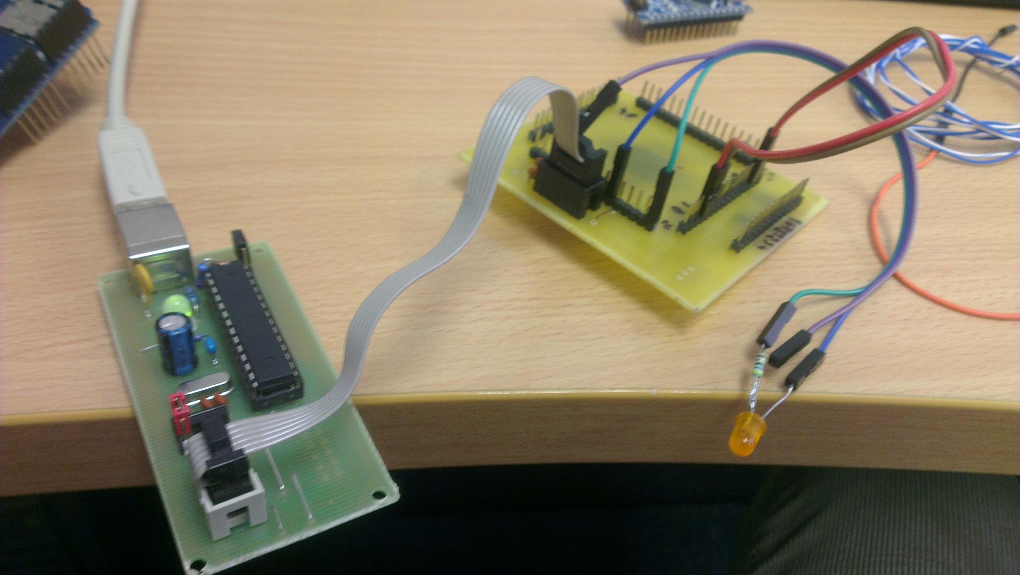

I need help with this configuration:
I use ARDUINO IDE 1.0.6, USBasp programmer and would like to burn arduino code to atmel ATMega 128A UA.
My boards.txt for board type:
crumbuino128.name=Crumbuino-128 w/ ATmega128
crumbuino128.upload.using=usbasp
crumbuino128.upload.maximum_size=126976
crumbuino128.bootloader.low_fuses=0xFF
crumbuino128.bootloader.high_fuses=0xCA
crumbuino128.bootloader.extended_fuses=0xFF
crumbuino128.bootloader.path=atmega
crumbuino128.bootloader.file=ATmegaBOOT_168_atmega128.hex
crumbuino128.bootloader.unlock_bits=0x3F
crumbuino128.bootloader.lock_bits=0x0F
crumbuino128.build.mcu=atmega128
crumbuino128.build.f_cpu=16000000L
crumbuino128.build.core=arduinocrum
crumbuino128.build.variant=crumbuino128
On this site I found core and variant files.
I would like tu test this BLINK LED code but notthing.
vs
#define F_CPU 8000000UL
Don't these need to be consistent?
Check these against the Fuse description in the Memory Programming section
http://www.atmel.com/Images/doc2467.pdf
pages 287-288-289
Make sure the fuse settings are compatible with your hardware setup, which you haven't really described.

this is mistake. I use only crumbuino128.build.f_cpu=16000000L.
My hardware you can see on picture down.
I use only pure ATmega128A AU with external crystal 16MHZ
I don't need bootloader. Is it necessary for me when I don't use bootloader?

HI everybody!
I solved this problem.
Over avr8-burn-o-mat I am check at fuses section in FUSE HEX editor if i have same set of hfuse,lfuse,efuse as in boards.txt in bootloader.
I not need to use bootloader pre mna that im am not write it in boards.txt it.
Thanks.
