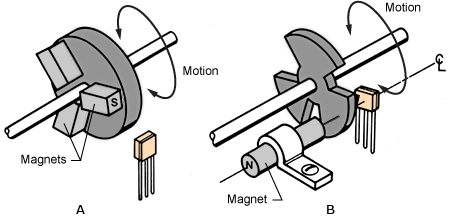

Dear friends how write code for 3 cylinder engine .
i want it with hall effect . i have hall effect sensor also it has reaction and works ,,but the problem is not it.
.i want it works together for ignition control .
i need a basic idea about it

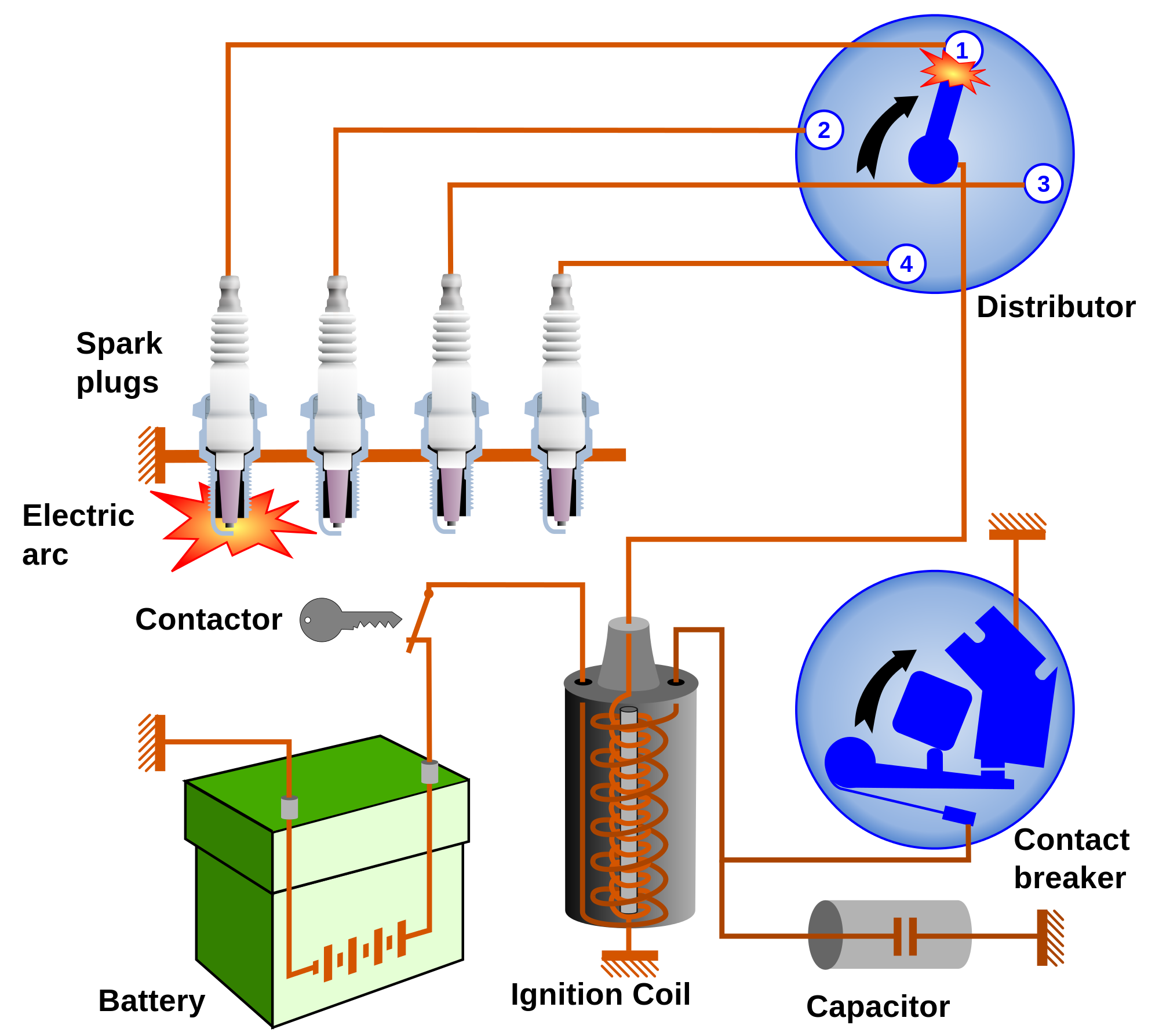

i put some pictures maybe help
First problem is you need a current limiting or voltage dropping, resistor in series with the coil primary. An automotive type coil rated for 12 volts actually operates on about 8 volts, EXCEPT when starting the engine from an electric starter. When starting, the load on the battery reduces the voltage to about 8 volts. The series resistor is shorted by the starter switch so the coil gets the 8 volts during the start up.
Paul
I don't recognise the mosfet. You'll need one rated at at least 500v and 6A . The IRF800 series are in the right area.
And they need more than 5v on the gate to turn them fully on.
Allan

so ,,main plan is :
what we need to have spark ?
need a transistor ( IRF800 ) to (off and on) the earth wire .
if something suddenly off the voltage ,coil will response as 20k voltage .and is that i need .depend of when
time is here is important .

first hall effect sensor .
second is optical sensor
.hall effect sensor or optical sensor tell us ,which exactly time must mofst .do off or don't do .
