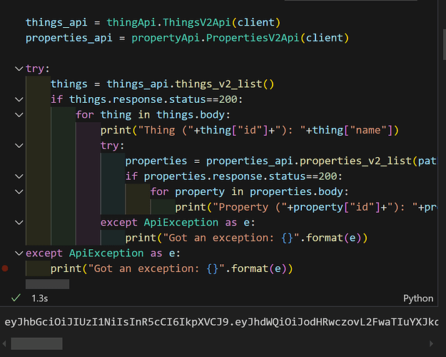

Hello @fzehra1,
For references and examples, you can see the Github repo: GitHub - arduino/iot-client-py: Python client for Arduino IoT API.
I started from the example in the readme and then added some calls to get things and properties using the package arduino-iot-client (version 2.0.1) and it works.
Here the code:
from oauthlib.oauth2 import BackendApplicationClient
from requests_oauthlib import OAuth2Session
oauth_client = BackendApplicationClient(client_id=YOUR_CLIENT_ID)
token_url = "https://api2.arduino.cc/iot/v1/clients/token"
oauth = OAuth2Session(client=oauth_client)
token = oauth.fetch_token(
    token_url=token_url,
    client_id=YOUR_CLIENT_ID,
    client_secret=YOUR_CLIENT_SECRET,
    include_client_id=True,
    audience="https://api2.arduino.cc/iot"
access_token = token.get("access_token")
import iot_api_client as iot
from iot_api_client.rest import ApiException
from iot_api_client.configuration import Configuration
import iot_api_client.apis.tags.things_v2_api as thingApi
import iot_api_client.apis.tags.properties_v2_api as propertyApi
# configure and instance the API client
client_config = Configuration(host="https://api2.arduino.cc/iot")
client_config.access_token = access_token
client = iot.ApiClient(client_config)
things_api = thingApi.ThingsV2Api(client)
properties_api = propertyApi.PropertiesV2Api(client)
try:
    things = things_api.things_v2_list()
    if things.response.status==200:
        for thing in things.body:
            print("Thing ("+thing["id"]+"): "+thing["name"])
            try:
                properties = properties_api.properties_v2_list(path_params={'id': thing["id"]})
                if properties.response.status==200:
                    for property in properties.body:
                        print("Property ("+property["id"]+"): "+property["name"])
            except ApiException as e:
                print("Got an exception: {}".format(e))
Let me know if it works also for you, thanks.
Hi s-torneo.
Thank you for your response.
I tried the code. it just prints the access token, doesn't list things or properties:
Hello @fzehra1,
Did you add a print for the access token? Because there is no print for that in my code.
If the code doesn't list anything for things and properties, maybe there is no things for that client. It's very strange, I don't think it is an API problem.
hi,
thank you for your response.
Yes, I added print to make sure it was getting the access token. I passed the organization ID in this line and it gave me the list of things and their properties
client = iot.ApiClient(client_config,header_name="X-Organization", header_value=org_id)
Thank you for your help.

Hi @s-torneo
I am using the dashboard currently. however I wanna do some analytics study and get data from API to another platform to use python fo processing data and storage and get the historical analytics or statistics.
