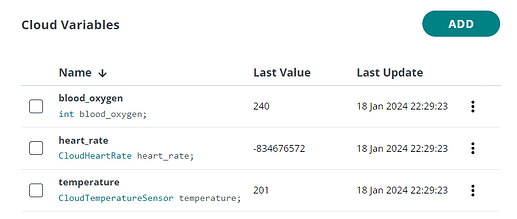

Hi everyone,
I am using an arduino nano ESP32 with a MAX30102 sensor to sense heartbeat and blood oxygen.
I tested this using the arduino IDE and it works perfectly and senses the data correctly.
I wanted to set this up with the arduino cloud so I can see the data in the dashboard on my phone.
My code compiles and uploads fine and the serial port also shows the data being read and the dashboard also updates correctly. However, the data being read is wildy inaccurate as you can see below...
This is my code:

Does anyone have any idea why this is happening or if I can fix it?

Hi @amirutha,
Try setting your Cloud Varable types to Floating point numbers (Float)
HTH?
I tried changing all the data types to float and it's still giving me incorrect values...
Same problem here.
Hi @nilsontfilho. Please post your full sketch.
