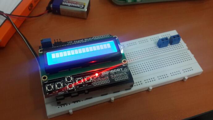

recently I purchase an Arduino LCD16*2 Shield for my UNO!
I upload the codes to my UNO but nothing shown on the LCD!
I tried the LCD test code, but nothing happened again!
I attached the LCD display picture while working, I pushed the buttons but there is no change on it!
I tested this code and library, any Idea? what should I do to run it?

Well, for a start, you need to provide the actual Web links for any and all modules you are using.
Then you need to explain where you found that code.
Then you need to explain - a perfectly focussed picture in good uniform light would probably be very helpful - what "not working" actually means. It might have to do with whether the backlight lights up, whether anything at all shows on the LCD, and so on.

Hi everybody ... Thanks for your keen responses ... I said the Shield model above!
this is the shield web address
and this is that website which I purchased it from there!

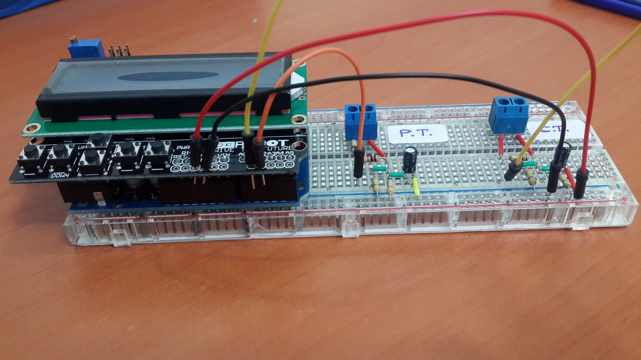

I attached some photos of the shield, I just want to run it as a normal device!
I tried the default codes, but nothing happens.

Surely you plug one LCD shield into your Uno. Then upload the example code that comes with the shield.
If you just get black boxes like the middle photo, there is a serious problem.

Your last photo shows unsoldered jumper wires stuffed into plated through holes. This is unwise (tm).
David.

I uploaded the LCD Shield testing code example in the UNO, but black boxes still exist !
:frowning: what is the solution? where is the problem?
The shield contrast popotentiometer dosn't work ... I mean it hase no effect to the back-light of the LCD!
You appear to be confused. The potentiometer is in no way related to the backlight. What did you actually mean?
Another two things worry me. One is the picture showing an LED plugged into pin 13 and ground without a current limiting resistor.
The other is that the picture on the website from which you purchased it suggests that it may be the faulty version detailed in the topmost post on this subject board.

Well, I cannot help beyond that. I have now tried that code with that shield and apart from the fact that the backlight does not light up because the wiring fault on my shield has been safely corrected (not easy), and the threshold values for detecting the buttons are slightly wrong since they actually have to be "tweaked" for each individual shield, when illuminated by a torch :grin: , the display correctly responds to the buttons.
Obviously you would have checked to see that no pins are missing (except the D10 pin which can be removed to prevent damage due to the wiring fault in the original board, fixed in the "Version 1.0").
While it is possible that the shield is faulty, I have a nasty suspicion that the code is in fact not actually uploading to your UNO.
Ok friends ... its working now, the problem wasn't from code or boards, it was from mounting the LCD shield on the Arduino! I pressed on it with more power, and everything went ok.
