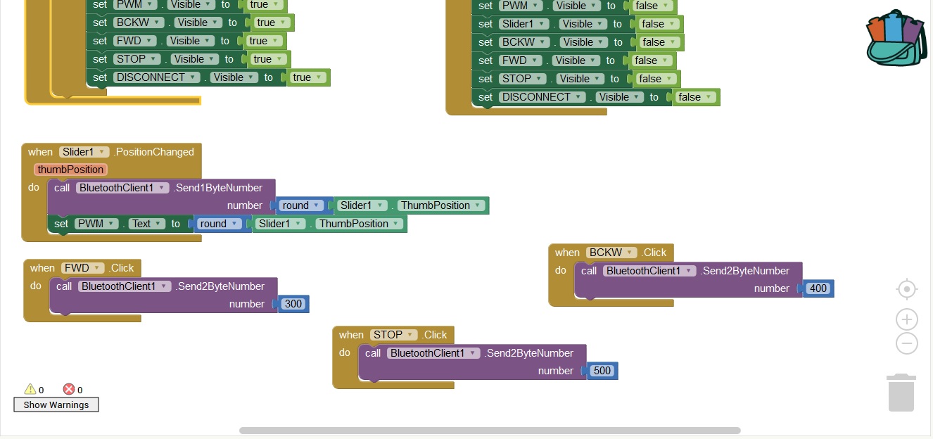

I am working on a project using Arduino Leonardo to control a DC motor via Bluetooth using an app on my andriod phone, so i want to control both direction and speed of the motor. I saw a tutorial about such topic showing sending 2Bytes number from android then combine them into one number (Byte1*256 + Byte2) and i thought that is what i need coz i want to send both speed value and direction to Arduino which can receive one Byte at once and as PWM values are 0 - 255 so i need another byte to send the direction too. i used MIT app inventor to create the app..the problem now is : this code works well on Arduino Nano but doesnt work on Leonardo that means it dosent respond and when i send for example 1000, i get on Serial monitor (12337, 12336) !

Which pins on the Leonardo is the bluetooth device connected to? Pins 0 and 1 go with Serial1, not Serial, on the Leonardo.
The serial monitor sends text, not numbers.
Subtracting the character '0' from the received character will give you the number (0..9).
E.g sending "19" results in receiving characters '1' and '9'. Subtracting '0' will give you the numbers 1 and 9. Multiply 1 by 10 and 9 by 1 and sum and you have the number 19.

In that event, I think your only problem is that you need to use Serial1 instead of Serial, as pointed out in reply#2, and which you appear not to have changed.

If your sender is sending two bytes, why are you storing the bytes in signed variables that can hold values from -128 to 127?
Why are you then thinking that converting the ASCII representation of a digit to a number is a useful thing to do?
If the sender is sending ASCII data, then the first two statements, to read a value like "100" don't make sense.
Just what IS being sent? Just why are you using char variables?
