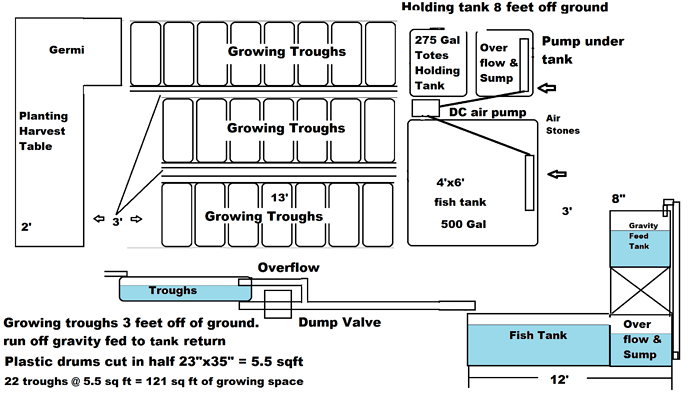

the system consist of one air pump (60 watts) not controlled by Arduino, one water pump (80 watts) and two 2 solenoid valves (12.5 watts each) controlled by Arduino Leonardo and 5 volt relays.

I also forgot to add the layout of my system. it is an ebb and flow system meaning it fills then drains on a continuous cycle. the system is a gravity fed system that requires far less energy than your regular Aquaponic system that cycles continuously. the system times can be changed but i like it set to 8 cycles per 24 hrs giving the plants enough soak time to absorb nutrients and clean the water then drain to fish tank then to overflow sump tote to be re oxygenated for the next cycle.

This sketch controls an Ebb and Flow Aquaponic system utilizing three relays and led lights for visualization of currant stage and upcoming stage. relay 1 water pump pin 2, relay 2 gravity feed solenoid valve pin 3 and relay 3 grow bed drain solenoid valve pin 4.
1-5 led's indicate stage complete pin's 5-9, led 6 is upcoming stage indicator pin 13.
stage 1 pump, stage 2 flood, stage 3 soak, stage 4 drain and stage 5 aerate.
Relays power to opto's are all tied together so each relay pin connected to the Arduino has to go low
before the relay will turn on. high means off, low means on, so in setup declare them high before loop otherwise all three relays will be on because the Arduino starts all output pins low. led indication is a different story, they are started low and go high to be on.

what i need to do is make a schematic of the system as a whole but what i have posted so far will get a person there.
