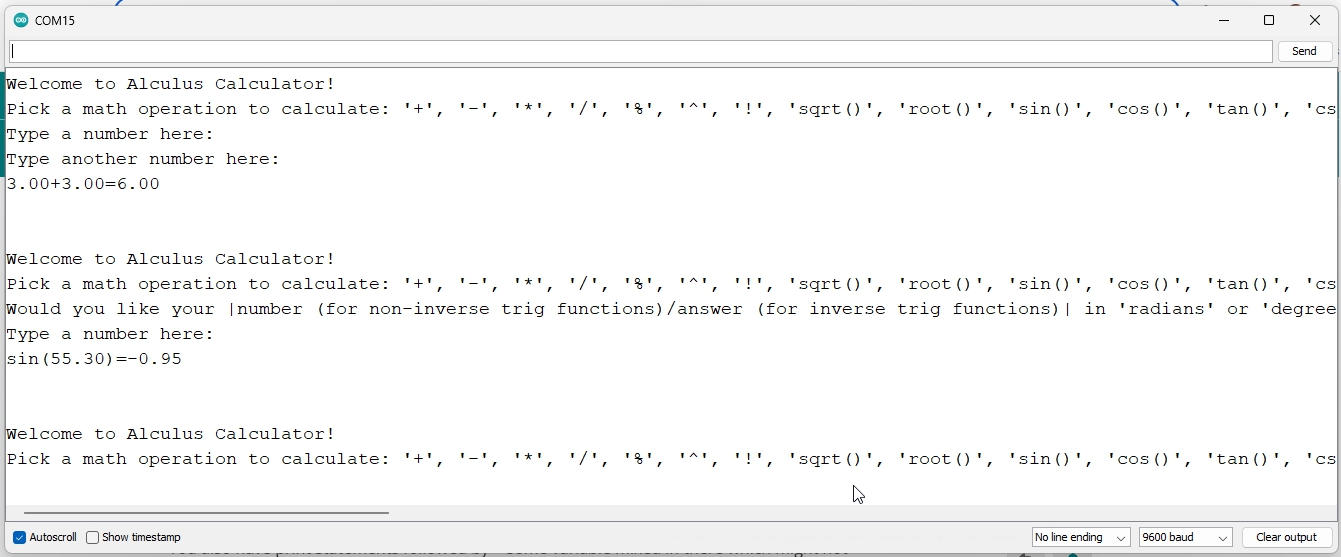

EDIT: I used my Arduino on Autodesk Tinkercad, not on the actual Arduino, which might be the reason for my errors.
Whenever I try to test my calculator to see if it is working, for some reason, when it gets to the part where it performs a calculation in my code, the part where it prints out the equation with the numbers and the answer just disappears to no avail.

For example, if I wanted to do a simple math operation such as "3.00+3.00", I would just get "=6.00" instead of "3.00+3.00=6.00".
If I wanted to do a complicated math operation such as "sin(55.3)", I would get absolutely nothing instead of "sin(55.3)=-0.95"
Here is the code where it cuts off the text:

I tried the solutions from other similar Arduino posts, but they did not help. What do you think I should do?
Have a look at the print statements , they are not consistent with the brackets .
You also have print statements followed by + some variable mixed in there which might not react how you think it should ?
I need a wider screen.
You are printing a message consisting of 429 characters on one line - not very user friendly.
I see '3.00+3.00=6.00' and 'sin(55.30)=-0.95'.
The way you deal with your input is not great either for your goal
There is no way your test for c == "sin()" to work out for example
You need a much better parser and not depend on the readString() function which will read all the input until the timeout.
PS: your float can’t deal with that precision level. If your are using a 32 bit MCU you could use the double type instead of float to get more decimal digits.
Hopefully you are not compiling for an UNO or any other board with a small amount of ram, the extensive use of String will very likely cause problems.

The solution: Separate different terms from
Serial.println(String(a) + "+" + String(b) + "=" + String(a+b));
into
Serial.print(String(a)); Serial.print("+"); Serial.print(String(b)); Serial.print("="); Serial.print(String(a+b));
Thank you to all who contributed to this problem and giving out suggestions!
Edit: I also thank those who contributed to this problem after I wrote this original reply/post.

Have fun :wink:

Additionally, the format that was presented in was in float. For some reason, Arduino ONLY shows up to 2 decimal places in float values. However, float values actually extend way more to a range of values for decimal places from 13 to 15. Hopefully that answers your question.
Filler-in Details:
I just recently finished all of my trigonometric functions, especially the inverse ones. It is not in the post, though. I discovered that they were bugged, and I just fixed them. The problem I faced in this post was when the text part cut off. However, since I already fixed it, my only main issue was getting the trigonometric functions to be at least two decimal places accurate, which was what I needed. I just finished that during 4:00 AM in the morning, so no big deal or whatsoever- just ONLY wanted to make something humorous.
Reply to ec2021
Thank you for making a solution for me! Even though I have already solved my own issue before you posted your own version of the code, it looks very well organized and professional unlike mine, where I just try to compress everything. Anyways, I just fixed all of my trigonometric functions, especially the inverse ones. The issues of the pre-existing trigonometric functions that I made are also fixed. They now work as intended. The purpose of the answer precision was meant to be 2 decimal places. However, I made them accurate up to at least 7 decimal places. If you want more details on how I have made them, you can go read at the reply/post above this one. It specifically addresses doubts from J-M-L Jackson. If you want more explaining, I am happy to explain the trigonometric functions I made in depth. Even though it will take me a while to write, I enjoy working and explaining on math and coding/programming. They are some of my hobbies.
Reply to J-M-L Jackson
The float values are displayed to two decimal places. However, Arduino keeps track of the other decimal places that extend to 13 to 15 decimal places. You can refer to the other reply I sent you. Thank you for expressing your thoughts!
That is because the conversion to String, and the print() function if you are printing directly, default to 2 decimal places when doing the conversion from float to ASCII. If you want more decimal places, you need to specify that by adding a 2nd argument to the String or print function:
    Serial.println("sin(" + String(a, 7) + ")=" + String(sine(a), 7));
    //prints float to 7 decimal places
Note that the float data type is limited to 7 significant digits (not decimal places) of precision. If you want 15 significant digits of precision, you need to use double, but that is not implemented on many of the Arduino boards because of the size of the code.

If that code change fixed anything it was because your previous expressions were causing the trouble Strings make happen soon rather than later (probably) or never (you clan always hope).
a7
well, the printing is 2 decimal digits by default but it's just a parameter of the print() function when passing a floating point number.
Serial.println(1.234);
Serial.println(1.234, 4); // will print with 4 digits after the decimal point
regarding your absurd claim that
you need to revisit the basics about the precision of float and double in IEEE representations.
This is governed by the number of bits allocated to the significand (aka mantissa), which determines how many significant digits can be represented.
In IEEE 754:
A float (single precision) uses 32 bits:
1 bit for the sign, 8 bits for the exponent, and 23 bits for the significand, with an implicit leading 1, giving effectively 24 bits of precision.
A double (double precision) uses 64 bits on 32 bits arduino but will be only 32 bits (ie same precision as a float) on UNO:
1 bit for the sign, 11 bits for the exponent, and 52 bits for the significand, with an implicit leading 1, giving effectively 53 bits of precision.
This bit width of the significand directly controls how finely numbers can be distinguished. The more bits in the significand, the smaller the difference between two adjacent representable values, and thus the higher the precision.
On average, a 32-bit IEEE 754 float gives about 7.2 decimal digits of precision, often rounded to 7 significant digits.
A 64-bit IEEE 754 double gives about 15.95 decimal digits of precision, typically rounded to 15 or 16 significant digits.
