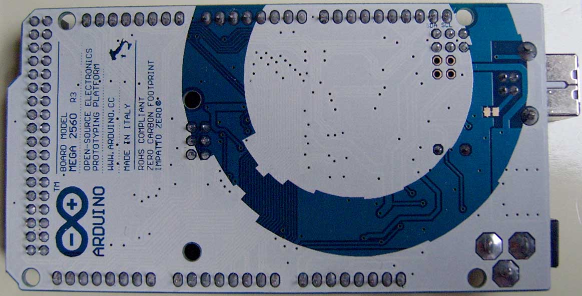

I have the same problem with Mega 2560 R3. I have tried grounding the Reset pin quickly, as well as held for 10 seconds, it always disappear and reappear as COM device. DFU mode never showed up. I have googled around for a whole day and found no solution. Really need help.
I took some pictures of my board, can you see anything missing? There has to be some way to enter DFU mode, right?
I found out my board had only usbserial firmware. I’ll see how to burn the combined one without DFU mode.
I made it. For unknown reasons my fresh mega 2560 r3 had only usbserial firmware loaded in Atmega16u2. So all I need to do is burn the big combined firmware. Here is how.
