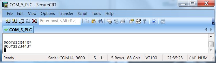

I figured out how the PLC 'hostlink' protocol works and did some simple tests using an RS232 serial cable and my laptop using a terminal program.
PC --> Serial Cable --> PLC
The terminal connection settings are 9600, 7 Data bits, Even Parity and 2 Stop bits.
When I send the command : @00TS123443* the PLC responds with the same string : @00TS123443* (This is for testing purpose)

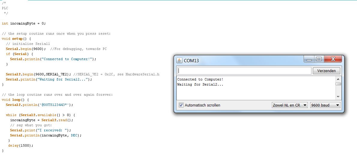

The code, as you can see it basic :slight_smile:

  Serial2.begin(9600,SERIAL_7E2); //SERIAL_7E2 = 0x2C, see HardwareSerial.h
  Serial.println("Waiting for Serial2...");
// the loop routine runs over and over again forever:
  Serial2.println("@00TS123443*");
  while (Serial2.available() > 0) {
    incomingByte = Serial2.read();
    // say what you got:
    Serial.print("I received: ");
    Serial.println(incomingByte, DEC);
   delay(1500);

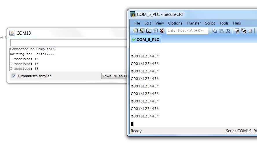

If I connect the Arduino to a serial port on my PC, I can see the correct string being sent by the Arduino.
Arduino --> WaveShare RS232 shield --> Serial Cable --> Serial-to-USB adapter --> PC
