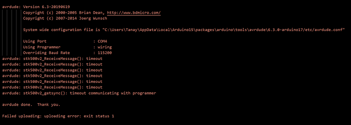

Attempting to upload a sketch (or separately trying to upload a .hex file through the terminal) returns avrdude: stk500v2_ReceiveMessage(): timeout errors. Notably, the RX LED remains blinking. I'm quite lost here. This is a new board we just purchased. What could be causing this? Is there something I'm doing wrong?

You can run the Loop-Back Test Instructions. If it fails, we known that the problem lays with the 16U2. If it passes, the problem is more than likely with the 2560 processor.
When you press and release the reset button, does the L-LED flash a couple of times? If not, the 2560 does not have a bootloader or is damaged.
The board passes the loop-back test. The LED does flash when the reset button is released.
Hi @elaque. Given the information gathered so far, I am left with only two possible causes for the upload failure:
  • The bootloader was somehow corrupted.
  • There is physical damage to the microcontroller or its support circuitry.
