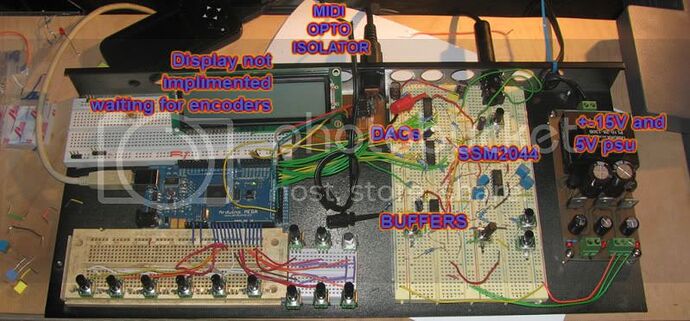

it has grown a bit, now the 2009 mega is being used with a 1977 SSM2044 filter IC, and also added power supply for +-15v (and 5v for arduino once its done being programmed) MIDI opto isolator is on a board, Parallel multiplying DACS for the wavetable outputs, opamp buffer etc.
the metal chassis is just a case from an old broken MIDI patch bay ii had. the holes came in handy for the MIDI in and audio out, and high tech "knot" strain relif for the PSU. everything is velcroed down except the PSU which has high voltage, so uses proper standoffs.
eventually when i am happy with the circuit i will build it on to a giant arduino shield. and a proper case.
It's looking gooood.
I used to build synths (http://mikmo.dk/synthstate.html), but have been looking for an Arduino synth project, a little more complex than the novelty beepers out there.
Looking forward to hear more from your project.
thats a nice modular synth there!
