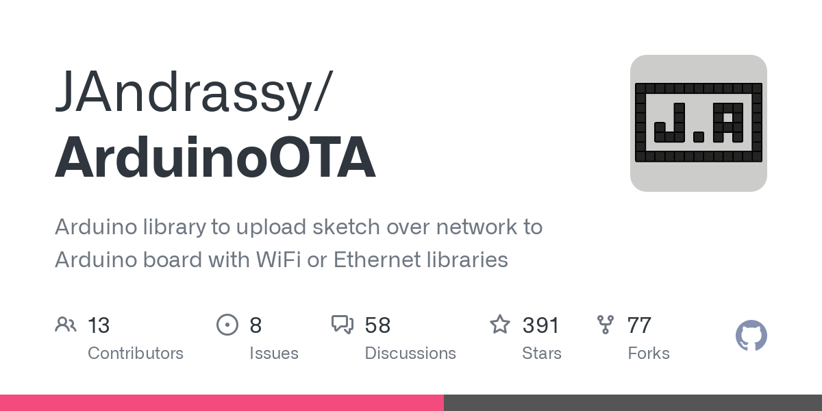

Does anyone have a solution or an idea on how to update the firmware of an Arduino Mega via the internet without the WiFi shield?
burn SD bootloader. then you can download the new firmware to SD card and self reset.
or
burn Optiboot with 'copy_flash_pages" function. then you can apply the downloaded binary over InternalStorage object of my ArdunioOTA library. InternalStorage uses upper half of he flash memory

if you can download it, you can apply it

I already mentioned my ArduinoOTA library
