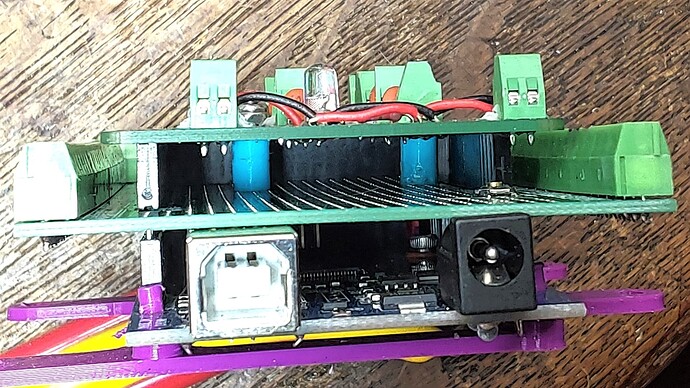

Third point - do those solenoid valves have diodes across their solenoids? If not, best to add them, because when they shut off, they WILL emit a significant transient.
I use meanwell 5V / 3A power supplies to feed a Power Distribution Board that piggie backs to the Mega.
It has screw terminals and bypass caps.
https://create.arduino.cc/projecthub/madmark2150/perf-panel-paired-power-plug-piggyback-for-mega-2560-uno-67d604
I repeat the question:
Does the Mega design differ from the Nano? Can you feed Vin (a specific pin) with 5V reliably? Or should you feed 5V directly, bypassing the regulator? because the OP's drawing specifically shows 5V to Vin, and his complaint is noise, resets, etc. which I would absolutely expect if I powered my Nano that way.

Then, until the OP fixes that, all other theories are wasted breath. Unless he mislabelled his schematic, he's feeding the Arduino 5V via Vin.
Case suspended, for now.
