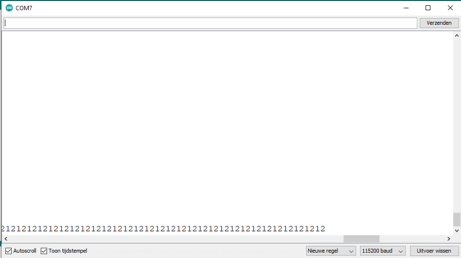

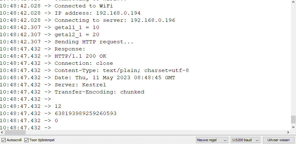

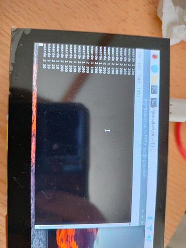

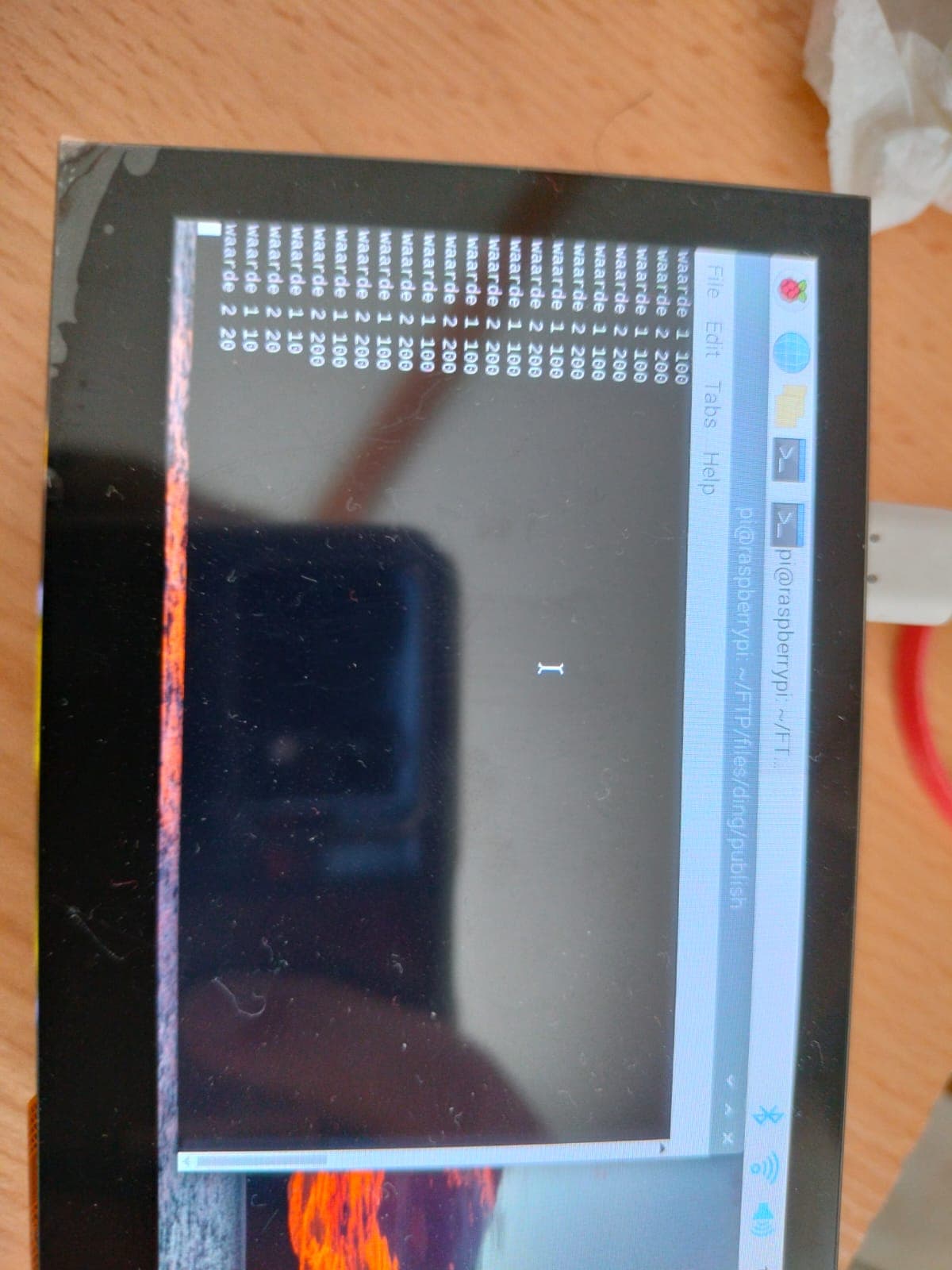

and here is the output on the Raspberry.
This is the Serial monitor when swiches 1,2,3 and 4 are on.
This is the Serial monitor when swiches 5 and 6 are on.
seems RPi handles data wrong or it is right received but you store or read out it wrong from file.
it isn't cause when you look at the output from the Serial monitor you can see that it doens't read anything on the serial bus. So the values transfered to the RPI are the ones declared in the start of the program.
show diagram where all parts are presented.
i see A_Mega sends proper, i see Serial Monitor from side of Serial shows proper, only not proper is text on the screen of RPi, so decision is simple - look post#2.
Look at this part of the code above. If the ESP8266 was reading something at Serial.available, then it would print out "Recieved from Arduino" and the number gotten from the Arduino. Now when you look at the picture below (also in the first post) It doens't show this message on the Serial monitor. So i must conclude that its not reading anything from the Serial bus. Or am I missing something? I mean maybe i'm stupid but i think if the problem was the RPI it would still show this message.
