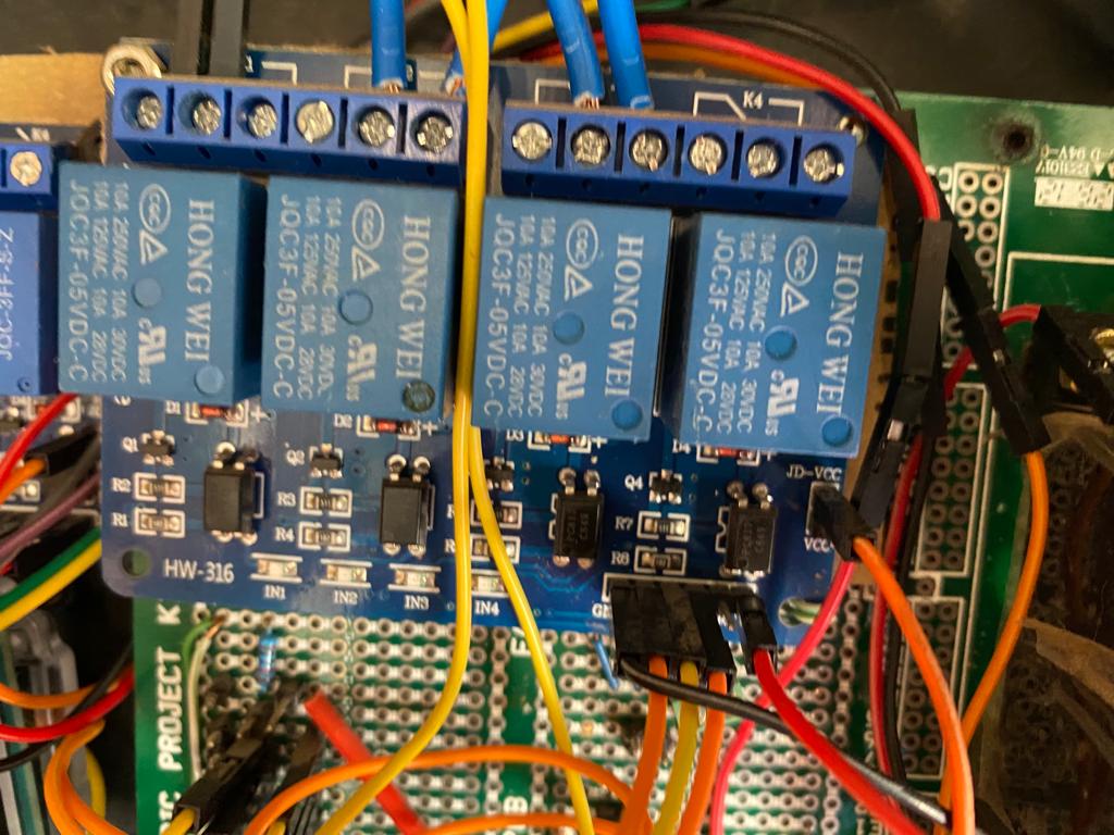

Circuit information
1.relays are connected to external power soruce
2. Only the LDR and RTC module are connected to arduino Mega
the Project works fine however after sometime i am not able to access to the web server to control the pump or the light
at the time of the issue i noticed the below:
  1. the circuit is not pingable
  2. doing hard reset resolves the issue and everything works fine again
i am not sure where exactly the issue is if someone can guide ..
