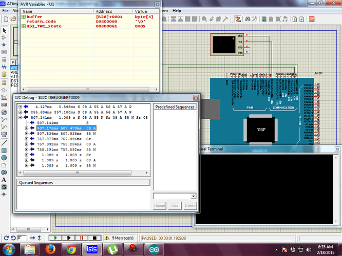

But even after removing the Serial function, nothing works fine. Just for two times and that two on I2C Debugger of Proteus Simulation
ATtiny85 Sends data -> Data Received by Mega + ACK
ATtiny85 Sends data -> Data Not Received by Mega + NACK (Clock Stretching is there again SCL line is low)
But one thing is strange, i am receiving Acknowledgement for Address, but NACK for data sent.

I tested it on real Hardware, and still no success :frowning:
Even i am not able to get data for single time, Clock line is low on mega2560
I'm out of ideas. Sorry. There is still a chance that they are incompatible. You need to find someone who knows about I2C on the ATtiny85.

Hi!!!
I am sorry,
i forget to un-comment this line
Wire.onReceive(receiveEvent); // register event
I checked on oscilloscope and found that everything was okay, then why i am not getting the response of serial port, when i came back on seat from lab, i found that Wire.onReceive(receiveEvent); is commented on code.
And after that everything works fine.
And yes once again, don't reply on simulations as same code is not working on simulation, and is working in Real Hardware.
