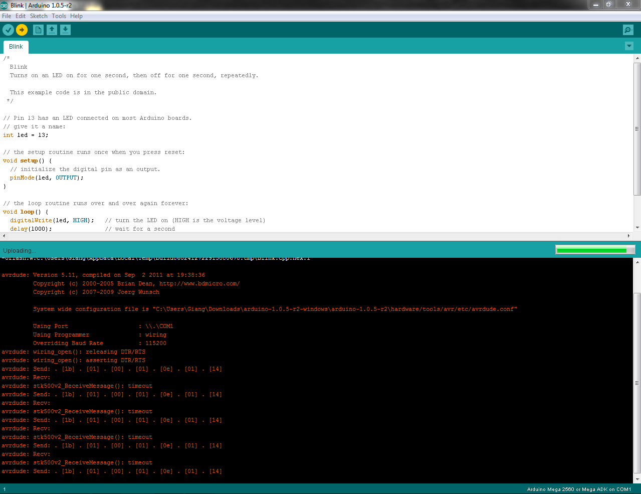

Dear all my friends,
I also faced the same problem during last 2 weeks.
  1. I have Atmege 2560 borad, i am using soft arduino v1.0.5 r2 and v1.6.5 r5. For testing loop-
back(bypass reset pin and Tx-Rx) is passed. I saw data feedback.
  1. I also change text in direction: hardware/arduino/boards.txt in 2 cases:
a) change upload protocol: wiring-> stk500v2
b) change upload protocol: stk500v2->stk500v2
Nothing improving, only one LED blink on Tx line blink.
Beside of that, I attached some screenshot which errors is shown.
Thank for your reading
Giang

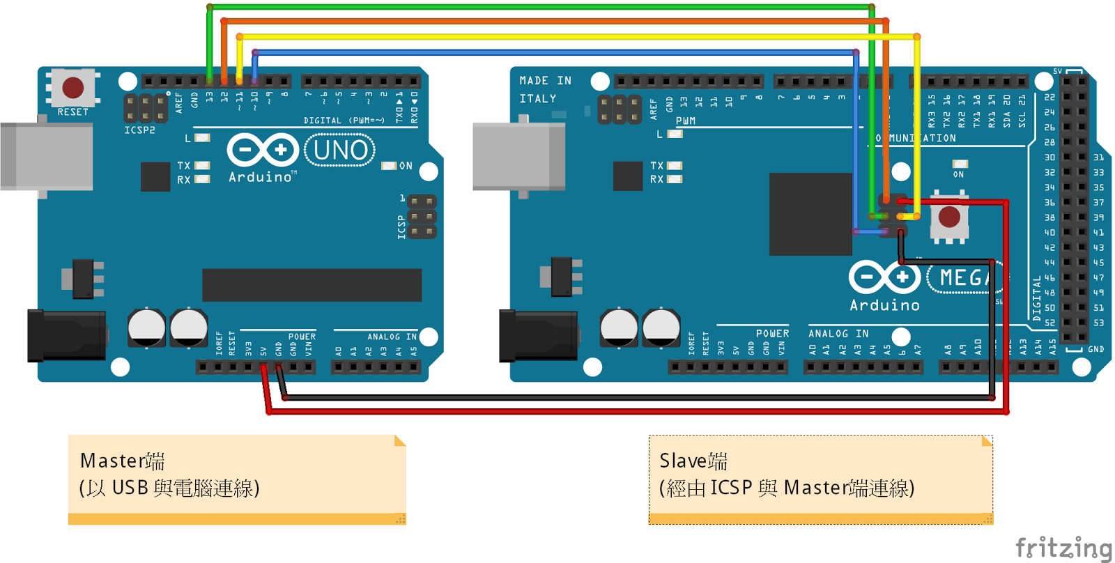

Hi all,
I was also facing this problem. I was searching for hundreds of sites for solution, but now I got it. In my case the problem was the missing bootloader. The "Blink" program was on the board, but personaly I coud not do anything with it. Fortunately I already have an Uno and a Nano which are working fine, so I could use the Uno (as ISP) to burn the bootloader.
I used this instruction:
And the pctures attached.
I hope, that I could help. :slight_smile:
