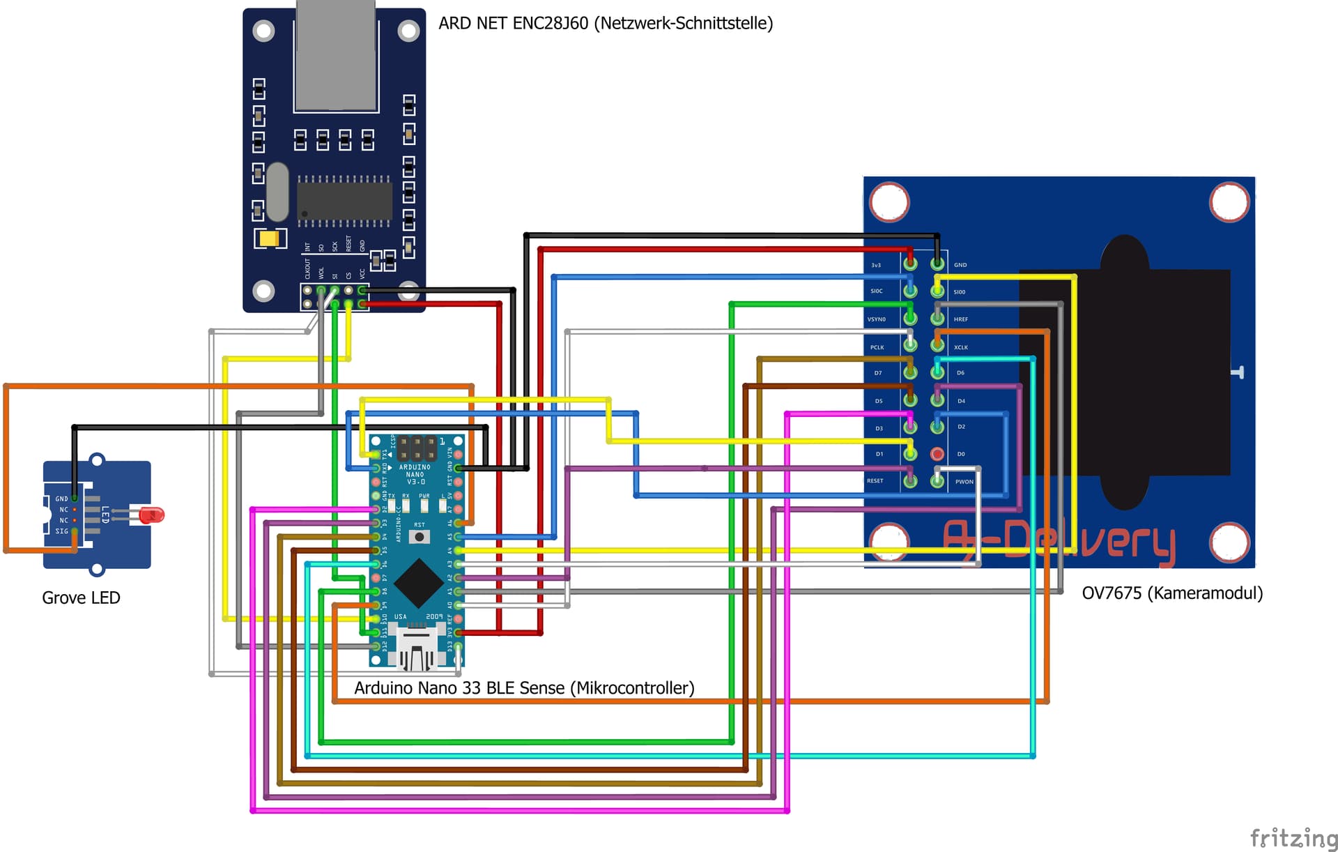

Hello, as part of my mechanical engineering studies, I am currently working on a project with the Tiny Machine Learning Kit. First, I wrote codes for the individual functions. In the final step before I can set up the code for the entire function, I encountered a problem where I cannot establish a connection to the ENC28J60 via SPI.
My connections:
VCC == 3.3V
GND == GND
SCK == Pin 13
So == Pin 12
Si == Pin 11
Cs == Pin 10 (as specified in the code)
(I used these two example codes)
Thank you very much for your help in advance,
Schumacher
Have you selected the 33BLE as your board choice ?
(Please refrain from posting images of text.)
the Ethernet library is for Wiznet W5x00 chips.
use EthernetENC library for ENC28J60

I have worked with the codes 'Link Status' and 'Advanced ChatServer' from the Ethernet library. I changed the library from "#include <Ethernet.h>" to "#include <EthernetENC.h>" and, of course, selected my CS pin. However, I have not been able to achieve any success yet.
The Arduino Nano 33 BLE was set up immediately after connecting, and the newest board package is also installed.
on the picture it looks like MISO is wired to SI and MOSI to SO
That is correct. Thanks for that, I have uploaded the updated version.
However, the hardware is connected according to this status.

try the WebCliebt example. it has enhanced diagnostics
Thank you, that helped a lot!
I got it running now.
