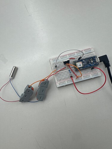

Arduino NANO 33 BLE REV 2 SCENCE not working with a vibration motor
This is our set up for wires and such and we've tried everything, from changing out each component, different usb cables, and even the same board, we've been able to get it to work on a UNO R3 but not our Nano 33 BLE Rev 2 Scence.

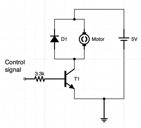

You need a seperate power supply for the motor. If you have not fried your Arduino you are lucky. Arduinos are not power supplies. From your picture I could not figure what you have or how it is connected. You have what appears to be a TO220 package, what is it and what is the pinout. Here is a schematic:
The ground of the motor power supply has to be connected to the ground of the Arduino power supply.
