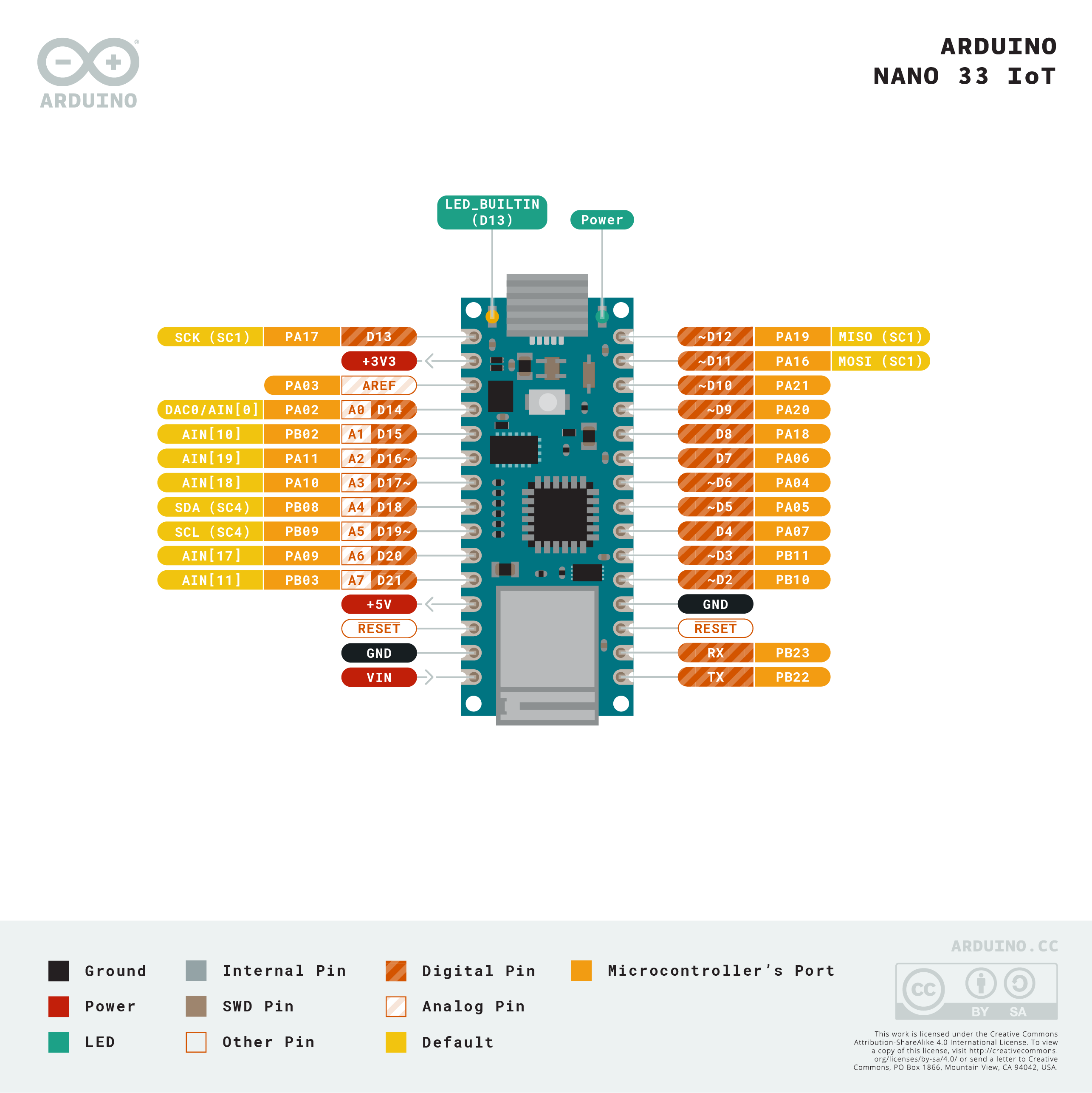

I have been trying to get the arduino nano 33 IoT (SAMD21) in sleep mode, when I wake Up with an externall interruption, it wakes up, but only while the interruption is activated

What is your example trying to show?
You configure one pin (12) as input but attach an interrupt to another (13).
You configure deep sleep but do not activate sleep.

I try to setup my arduino for sleep mode and then wake up and turn on the led for 10 seconds
When I activate the external interruption , the led turns on but only while I keep the interruption activated, It does not keep 10 seconds turn on.

So, when you apply a 3.3V to the pin, the LED lights up. When you remove it, the LED is switched off because you configured the pin as input. Your digitalWrite do not do anything. Luckily for you. This could damage your I/O.

I have changed the code with the interruption in pin digital 2 and sleeping the nano from the beginin,then when the interruption is activated the led blinks for 1 second and thens returns to sleep mode, However it never stops blinking, so it never goes to sleep mode.
