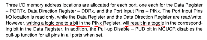

dear david_2018, I went to check out the link that you passed and to my surprise, I realized that this command only READ and does NOT write!!!
You can check in attached image.
But, it is working perfectly now, even with this command !!!

That's why it's better to read the manufacturer's datasheet, rather than various links on the Internet.
Having read the Atmega328 datasheet, you would have learned that writing a one to PINx register is a special case
Chapter 13 of Atmega328 Datasheet
