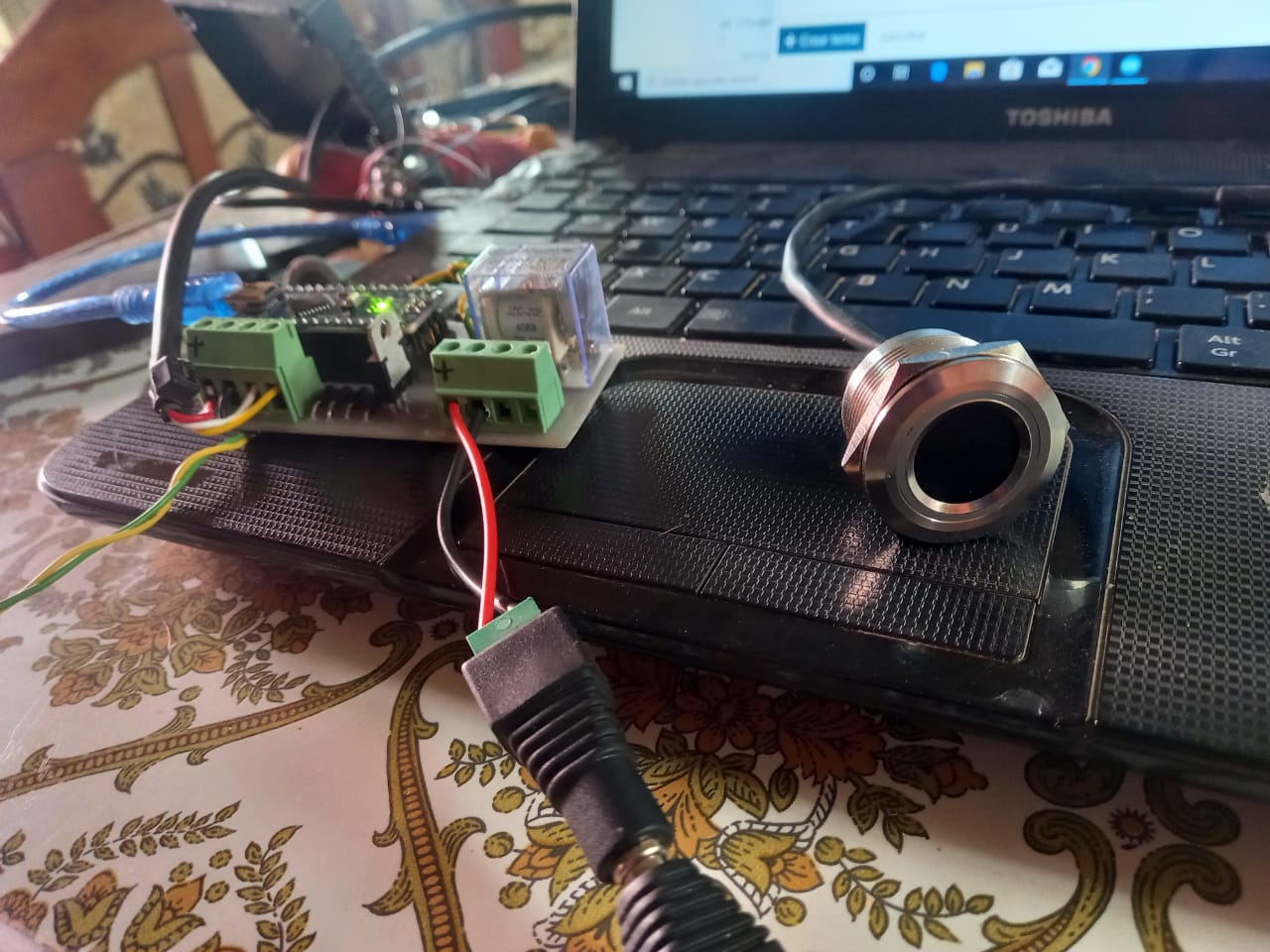

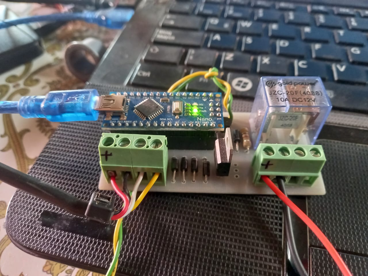

Arduino nano can't find fingerprint sensor
Estimates would be so kind with your support to solve this problem that I have.
I tell you about this circuit that I made with arduino nano, it gave me perfectly with the libraries that adafruit fingerprint has, everything has been that I formatted my laptop and reinstalled the arduino program and I wanted to register fingerprints, I get these errors, your support thanks in advance.

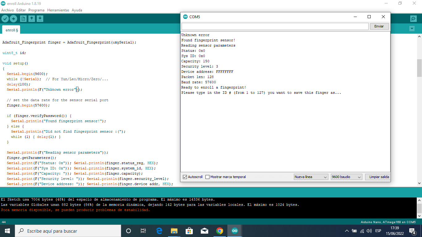

What are "these errors"? Perhaps you may be referring to the 90% RAM usage in your screenshot?
Post your code so that others can assist you.

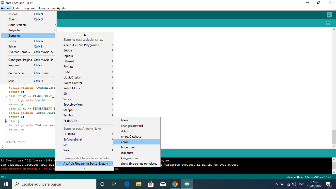

Is the code you posted one of the AdaFruit examples? If not, have you tried the examples that come with the library.
If it is exactly, it is from the same library, I will tell you about the other examples that the library has, if they work, the only thing it does not give me is the fingerprint record, then let's say if it reads the sensor, but as I say, it does not record the fingerprints. memory space to which it should be, as I say, that program has worked for me but before everything was that I formatted my laptop.
First suggestion I would try is to use the F() macro around all the string constants in your print/println.
For example:
Replace with:
Serial.println(F("Unknown error"));
Thst should give you some more RAM back. Maybe enough to remove the warning message and potentially fix the overall issue.
I tell you there I get that it recognized the sensor as it gave me in the example, but when I send a 1 so that I can save the fingerprint, it restarts at the start message.
I looked at the enroll example code for the AdaFruit fingerprint sensor and what you are seeing is correct. It seems that the enroll program simply captures and stores fingerprints.
Good morning dear, yes, as I mentioned there, the sensor already recognizes me with the modification that you indicated, but when I send a 1 to register, it does not allow me to return to the start, as I mentioned before, it gave me perfectly, as you see, my plates that I designed worked for me now nothing, what do you think would have happened.
I'm confused:
I indicate to the last images that I know that I was told to correct the serial print, I modified it to "F" there I lose a little memory, when I give a serial port the sensor already detects me but it does not register my fingerprint
Can you post your current sketch.

This may not solve your issue, but I've modified your code the put all the string constants into flash memory. The RAM usage has now dropped from 86% down to 35% when compiled for an Arduino Nano (Mega168).

What happens when you attempt to register your first fingerprint with ID = 1?
brother gave perfectly rather how can I help you how do I contact you
If the code is working for you, then simply mark my code as the solution.
Good luck with your project.
